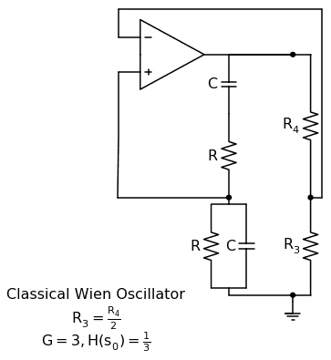

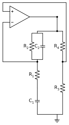

By Wien bridge oscillator (abbreviated as WBO below) I refer to this circuit where the op-amp is assumed to be ideal and the output is the voltage drained from the upper end of R3.

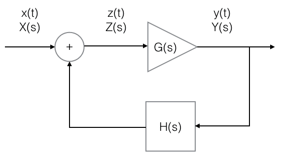

What confuses me is that I hardly find a reference which explicitly states that a WBO has a closed-loop transfer function. By closed-loop transfer function I refer to that of a negative feedback block diagram as follows in s-domain, e.g. [itex]ClosedLoopTransferFunc = \frac{G(s)}{1 - G(s)H(s)}[/itex], if the WBO could be modeled like so.
Will be shown in the following section.
The difficult part for me is to define/find the input to the WBO. As told to me by an esteemed person in a personal email, the WBO has no input, and thus its closed-loop transfer function shouldn't be defined. However this is kind of weird to me. I understand that in terms of energy conservation the energy is drained from a DC pull and converted to sinusoidal waves and possibly heat, that's reasonable, but the magical word "convert" is so outstanding here.
What I think is that there should be an abrupt impulse, or sharp edge of voltage/current amplitude change when the oscillator is "switched on", and that impulse contains all kinds of frequency components to be amplified or attenuated w.r.t. individual closed-loop transfer function of each.
My attempt to quantify this intuition, especially how signals are "addible in s-domain", is to assume that in time-domain there's an ideal impulse which is proportional to a Dirac delta [itex]\delta(t)[/itex] as input signal [itex]x(t)[/itex] when "switched on" in the block diagram. Then [itex]x(t)[/itex] adds with the feedback signal [itex]\mathcal{L}^{−1}\{H·Y\}(t)[/itex] both at [itex]t=0[/itex] and after [itex]t>0[/itex] in time-domain, where [itex]\mathcal{L}^{−1}[/itex] is the inverse Laplace transform, [itex]x(t \ne 0)=0[/itex] and [itex]\mathcal{L}^{−1}\{H·Y\}(t=0)=0[/itex]. Thus [itex]X(s)[/itex] and [itex]H(s)[/itex] adds in the s-domain as well due to the linearity of Laplace transform.
Moreover, my attempt to relate the 2 figures above is like the following.
where

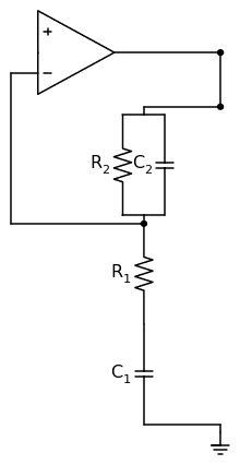

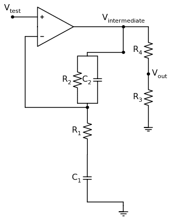

  • the first figure shows the ideal op-amp together with its negative feedback path being a finite-gain amplifier contributing to [itex]G(s)[/itex];
  • the second figure shows how the "closed-loop", if exists, is opened, thus [itex]H(s) = \frac{R_3}{R_3 + R_4}[/itex].
Is my attempt problematic? If so, does the WBO have any well defined closed-loop transfer function by any means?
All comments are appreciated.

Your block diagram is OK if you add a second feedback gain H2. H1 is - and H2 is +.
You can easily determine H1 and H2, then what is Y/X? In this picture, G = ∞.

@rude man I'm not sure whether I understand your argument, to my understanding, my block diagram below
is NOT PRESUMED TO BE a valid model of the Wien bridge oscillator below
, and this is an essential point where I'm confused about. It was my fault that this wasn't clearly stated.
The reasons are as follows.
  • The signals x(t), y(t) and z(t) are picked as VOLTAGES from different vertices in the Wien bridge oscillator. They're not marked in the figure because I'm still not sure about this argument.
  • There's an ADDER in the block diagram which is not obviously and physically mapping to any component to the Wien bridge oscillator. As previously mentioned, I consider the signals x(t), y(t) and z(t) VOLTAGES, which don't simply add by joining wires to a vertex. This is why I proposed that an ideal Dirac Delta [itex]x(t) = \delta (t)[/itex] might be able to constitute this ADDER in a mathematical sense.
Moreover, by [itex]G(s)[/itex] I'd prefer to say that it corresponds to the following block INSTEAD OF the ideal op-amp alone, which might be referred to by you as [itex]G = \infty[/itex].
The following block contributes to [itex]G(s) = \frac{(s^2 C_1 C_2 R_1 R_2 + s C_1 R_1 + s C_2 R_2 + s R_2 C_1 + 1)}{(s^2 C_1 C_2 R_1 R_2 + s C_1 R_1 + s C_2 R_2 + 1)}[/itex]. It's an s-domain dependent gain block which consists of the ideal op-amp and its negative feedback path.
Of course, one could make another blocking choice by taking the ideal op-amp with its positive feedback path together, but this is to my understanding a saturated configuration and thus doesn't yield a linear gain block. I'm open to the possibility that my blocking choice is wrong.
As of the Barkhausen criterion, I personally DON'T take it as a sufficient condition to start up the oscillation at desired frequency. Here're my references for this argument.
I'm not saying that Barkhausen criterion is incorrect here, it is satisfied (at the desired frequency) in this case but just in general insufficient to guarantee a sinusoidal output.
However it's well known that closed-loop transfer function equals the Dirac delta response. Hence if the closed-loop transfer function were determined to be corresponding to a sinusoidal oscillation, e.g. [itex]\frac{1}{s - j \cdot ( \omega_0)}[/itex], it would have been kinda easier to imagine how Wien bridge oscillator wipes out noises after given an impulse input.
Genxium, you forgot to write down the transfer function for the feedback block: H=R3/(R3+R4).
Because G(w=wo)=3/2 we require a nominal value H=2/3 for unity loop gain.

Yes - in principle, I agree. However, if we combine the gain block (G = ∞) with the negative feedback path (which is the frequency-dependent band-stop network), we arrive at a frequency dependent block G(s) as given in post#8. Hence, G(s) and H (fixed) form a positive feedback loop.

Is "voltage divider" referring to the path where [itex]H(s) = \frac{R_3}{R_3 + R_4}[/itex] is calculated from?
The voltage divider R3-R4 is connected to the + input.
My question was simply if you can explain WHY you have chosen this input (pos).
(Because for the original WIEN oscillator the resistive divider is connected to the - input).

Understood. The Wien oscillator variant used here is not chosen for special purpose, it's by far just personal preference that the paths are "reversed" compared to the classical wbo.
However this question and @rude man 's comments make me think of a mistake I've been making. In a simulation software, the computer wouldn't slice a circuit into such simple block diagram and run its analysis like I did. To my understanding the transient simulation of lumped circuit is usually based on differential equations and boundary conditions of each component. Moreover, the "infinite" quantities, e.g. δ or Gideal op-amp in discussion, if being reasonable arguments, should find their proper roles in the simulation data -- assuming that modern simulation algorithms have good prediction ability.
I'll collect some data from SPICE simulation of the Wien oscillator, and see whether something new for me comes out.

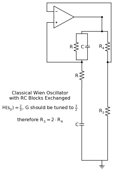

* We start with the original WIEN configuration (RC-bandpass in the pos. feedback loop).
* If we exchange the RC-series connection and the RC parallel block within the feedback path, we have a kind of bandstop network (with a transfer factor of 2/3 at the mid frequency where the phase is zero)..
* Hence, if we change the gain of the opamp amplfier from the previous value of "3" to the new value of 1.5=3/2 we can fulfill the oscillation condition bbecause of (2/3)*(3/2)=1. This requires an exchange of both gain determining resistors (R3, R4).
* This new circuit looks similar to your circuit - with one exception: The polarity of the opamps input nodes for the new circuit is reversed if compared with the oscillator circuit we are speaking of (as shown in your first post).
* NOW THE QUESTION AGAIN: Will both oscillators be able to oscillate (assuming, of course, correct dimensioning) ?

Back to your question. I hope that you could confirm my understandings to the following.
By original or classical Wien oscillator, are you referring to this one?
And by the end of steps of modification, should I get this Wien oscillator variant?
If yes, I merely see that it's different from the one I used to start this thread/discussion, but haven't got an answer to your question yet. Will answer after some efforts on learning the software.
Yes - exactly. That was what I had in my mind.
Back to your first sentence: I really meant "no satisfactory technical reason for the choice.
But there is, indeed, a specific technical reason for your (first) choice. And the background of my question was if you are aware of this reason.

Of course! And I'm especially curiously about why it doesn't even start with any noise of noticeable amplitude -- sometime before I worked with several "incorrect" Hartley/Colpitts models which at least gave noises at the beginning during transient simulation. Not sure whether there's a configuration fault or instead a compliance with existing theories.
May I ask for a hint?
Each oscillator must comply with the oscillation criterion and it must have a fixed DC bias point within the linear transfer characteristics of the amplifier.
Are both conditions fulfilled?
Understood.
Glad to say that the questions of this thread have all been resolved. I've put together involved netlist files on a git repository for reuse convenience https://github.com/genxium/WienBridgeOscTest.
May I add some more considerations?
It is true that the modification under consideration has no fixed and stable DC bias point and, hence, will not oscillate.
However, even the (novel) oscillation condition cannot be fulfilled:
The loop gain has - due to the reversed RC feedback path - now a band-stop characteristics (in comparison to the original WIEN network with a band-pass function). The resulting PHASE response of such a network has POSITIVE slope (rising phase). However, the updated (completed) oscillation criterion requires a NEGATIVE phase slope - see here:
https://www.researchgate.net/publication/255171263_On_a_rigorous_oscillation_condition?ev=prf_pub
