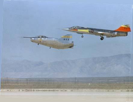

There are cases where the longer distance is on the bottom, and where the trailing edge isn't sharp. For example, the M2-F2 (glider) lifting body prototype re-entry vehicle. The trailing edge is not sharp because that is where the rocket engines were place in the later M2-F3.
Photo of two jet aircraft in flight over a desert with mountains behind: a grey lifting-body aircraft marked 803 on the left and a higher, orange-tailed swept-wing jet on the right.
You've posted that claim and that image several times before, without evidence that your claim is true -- the picture isn't evidence because you can't see the flow. I'm not inclined to accept your claim, without evidence that a lifting body works any different from a normal wing. Specifically, I bet the stagnation point is far under the chin and the airflow does indeed take a longer path over the top than over the bottom. The video of it landing at very high AOA compared to the F-104 flying next to it implies that should be true.
Further, even if true I think it is unhelpful to use an outlier when trying to teach the basics. It's a great way to create wrong impressions of what is typical or best. I'm sure a brick generates lift at a small positive angle of attack, but we shouldn't be generalizing that or listing it as a noteworthy exception.
For the purposes of my statement, a flatback and a sharp trailing edge both achieve the same thing: they prevent flow from wrapping around and effectively enforce a rear stagnation point. There are some additional interesting effects when it comes to flatback airfoils that make them a really useful choice for very high thickness airfoils, especially when you also consider structural properties of your airfoil section on top of just the aerodynamic effects.
Also, it's not necessarily useful to use your M2-F3 example as an airfoil at all. It doesn't behave like an airfoil, because the flow isn't even close to 2D. I would bet that a large part of the lift on that is actually related to vortices around the sides onto the upper surface, similar to a delta wing at high AoA, and there are so many 3d effects impacting the flow that I don't even know that you could meaningfully talk about "path lengths" for the flow except right on the centerline.
