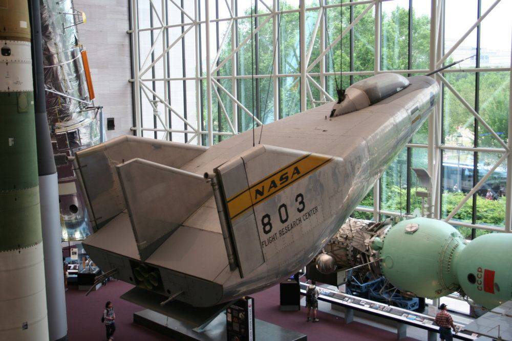

m2-f2
Here's a better image, in this case the M2-F3. The AOA is high when landing, but this was a re-entry prototype that reached a max speed of mach 1.6 during tests. It does need a high AOA for landing, but at speeds around 400 knots, AOA and lift to drag ratio would be reasonable, probably similar to the Space Shuttle. In the case of the Space Shuttle, lift to drag is 1:1 at hypersonic speeds, 2:1 at supersonic speeds, 4.5:1 at sub-sonic speeds. These are somewhat low since the reentry to landing time is already 20 minutes, and reentry to landing distance is 5,000 miles. Two big turns in the shape of an S are done to scrub off speed and stay within reach of the landing zone.
Photo of the NASA M2-F1 lifting body aircraft displayed in a museum atrium, marked NASA 803 Flight Research Center, with a green Soviet CCCP spacecraft capsule at right.
rcgldr said:
I was referring to the separation of flow point, which is well ahead of the stagnation point and below if the wing is generating lift.
That isn't a meaningful distinction. The streamline that contains the stagnation point is also (by definition) the "flow separation" line. You're right that (at least for incompressible flow) this streamline will always be upward sloping for a 2D flowfield around an object making lift, so some air that starts below the wing will end up traveling above it.
I would kind of expect there to also always be some upwash in front of something like your M2-F3 example during flight in the incompressible regime, despite the much more complicated 3d flowfield. I just don't want to definitively make a statement that you couldn't have some weird 3d effects that would allow for lift generation without leading upwash. I can't envision how that would work off the top of my head though.
Also, just as an interesting counterexample (though this is way outside of the discussion above), in supersonic flight, the incoming flow will just split exactly where the leading edge is. Anything that starts above the wing stays above, and anything that starts below stays below. This is of course intuitively obvious though, because disturbances can't propagate forwards in a supersonic flow.
