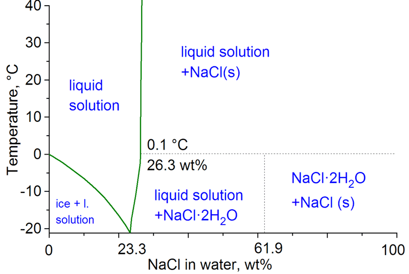

Not sodium chloride. Sodium chloride nicely precipitates as dry salt above +0,1 C, and is actually stable to above boiling point (over 1400 C)
