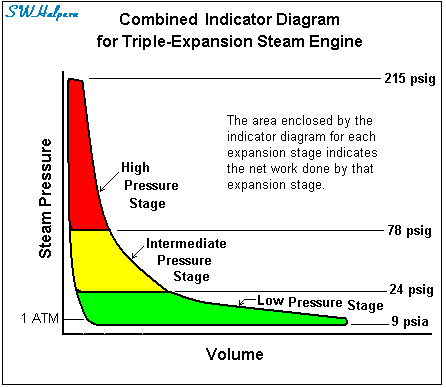

A pressurized gas is injected into a piston and work is extracted from the piston as it expands. When it is expanded it is still under pressure. The pressure is released and used to drive a turbine.
Theravenhouse said:
Thank you! That is a much better way to explain it.
A double expansion engine.
The Titanic had a triple expansion steam cycle, and/or four when the turbine was in use.
http://www.titanicology.com/Titanica/TitanicsPrimeMover.htm
A way to get as much out of the shoveling of tons of coal needed to power the vessel.
