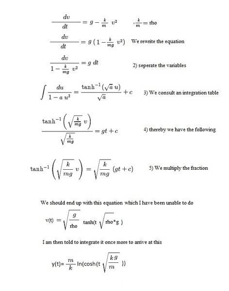

I would like to derive the air resistance equation showed in the attached photo. A little while ago, I tried asking at a different forum, however, the users were very experienced and omitted several stages of the derivation, and thereby made the interpretation difficult as I am new to math, but extremely eager to learn. I hope someone can help me illuminate each step of the derivation process, this would be a great help for my future studies, which are independent - I am not attending school at the moment. I have spent much time with this problem and I appreciate all help

I think that that second-to-last equation where you finally get v(t) to the left hand side follows from:
<br /> <br /> tanh ( arctanh( \sqrt{ \frac{\rho}{g} }v ) ) = \sqrt{ \frac{\rho}{g} } v = tanh( \sqrt{ \frac{\rho}{g} } (gt + c) )<br /> <br />
Which follows from the given fact that \rho = \frac{k}{m}.
From there it's a matter of rearraning, and using what I assume will be some given physical constraint which tells us that c is 0 or may be taken to be 0.
To do the final step, it's not immediately clear to me how to integrate that, I would consult an integral table for integrands containing tanh(z) .
Hope that helps somewhat.
Note also that tanh^{-1}(z) denotes the inverse hyperbolic tangent, or arctanh(z), and not the reciprocal of tanh(z). That would be coth(z).

Yes, I have studied calculus and differential equations, and solved many different types of problems, but I am unable to solve this specific problem. When I wrote "new" I meant that I had not studied differential equations for several years
Thanks Ocifer, now I am one step further, will update the picture I uploaded later today.
