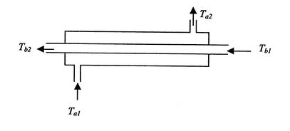

Came across this: https://web.mit.edu/16.unified/www/FALL/thermodynamics/notes/node131.html
would "18.5.2 General Counterflow Heat Exchanger" give me what i need?
Yeah, sure.
Here's another one, same thing, with LMTD.

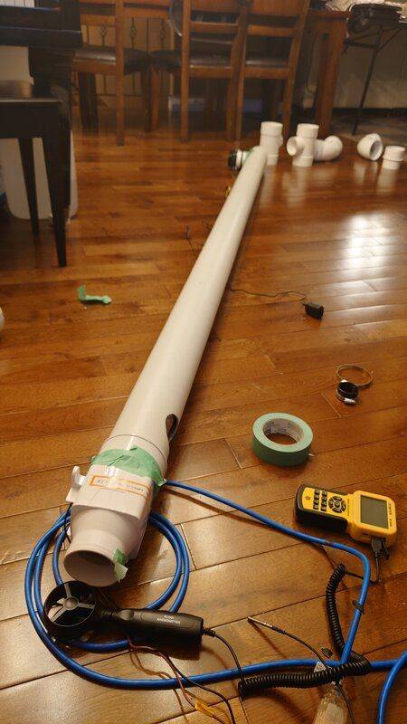

I built a basic counter flow prototype. It was a warmer day today so I didn't get to test it in negative temperatures ( I will over the next few days).
It is a 3"x8' flexible aluminum tube, inside a 4"x8' pvc pipe. using two fans. one fan sucking from out to in, and another fan sucking from into out. I measured a higher CFM using the anemometer when it was sucking vs blowing air ( i don't know if that's just these fans).
performance:
16C inside
10C fresh air out (going inside)
6C outside
~20CFM in and out
How can I calculate its efficiency, or total watts saved in heat? to see if its worth it for the space it will take up in my campervan.

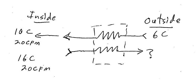

First, a diagram to make sure that I understand your description:
The efficiency is the heat added from the heat exchanger divided by the total heat needed, while the energy saved is the heat added from the heat exchanger.
Energy saved is calculated as follows:
Total heat needed is ##(16 C - 6 C) * 1.8 deg F / deg C * 20 CFM * 0.018 BTU / ft^3 / deg F * 60 min/hr = 390 BTUH ##
Heat added from heat exchanger is ##(10 C - 6 C) * 1.8 deg F / deg C * 20 CFM * 0.018 BTU / ft^3 / deg F * 60 min/hr = 160 BTUH ##. This is the energy saved by using the heat exchanger. Then divide by 3.412 to get watts: ##160 BTUH / 3.412 = 47 watts##. This heat exchanger was saving 47 watts under the conditions listed above.
The efficiency is ##160 / 390 = 40##%.
