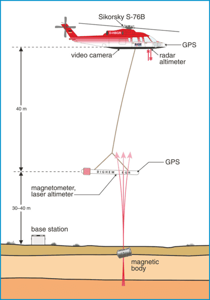

Hi,
Thank you very much for the quick reply, actually. the case here is about an airborne Magnetometer bird, just wanted to know if there is any benefit of having the Mag sensor on CG instead of on the Tail section, The argument I heard from my colleague is Having on the CG is better because having it on the Tail section will cause amplified moments due to the arm, does this make sense? , I thought it doesnt matter like that
Like this?
https://www.bgr.bund.de/EN/Themen/G...omagnetometrie/aeromagnetometrie_node_en.html
Yes, exactly, only difference is we are hanging it on one point, just above the CG,
How do you keep the sensor body horizontal if you only support it at the CG?
It is balanced on the CG , and CG is Infront of the Center of pressure, and it stabilized as it speeds up, usually 15 m/s forward speed.
cessna1525 said:
are there any benefits of having a Sensor on CG than fixed on the tail?
The orientation of the magnetometer will vary in the same way, independent of its position on the bird.
However, the distance of the magnetometer from the tow vehicle, and from the ground, will vary with the changing orientation of the bird, but will be minimised if the instrument is close to the centre of mass of the bird.
