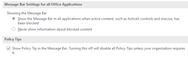

I'm not sure if the free version has the same setup, but:
Options > Trust Center > Trust Center Settings > Message Bar > Show message bar...

russ_waters: when (on my computer) I follow that path, I have
Are you saying that the pupil (or his father, given the warning against changing the settings at the beginning of this path) should go there to make sure that his message bar settings match these?
nomadreid said:
russ_waters: when (on my computer) I follow that path, I haveView attachment 281569
Yes. I think Excel just isn't showing the notification and that will bring it up.
Alternately, he could reduce the security settings so it doesn't block such content to begin with, but there is risk in that.

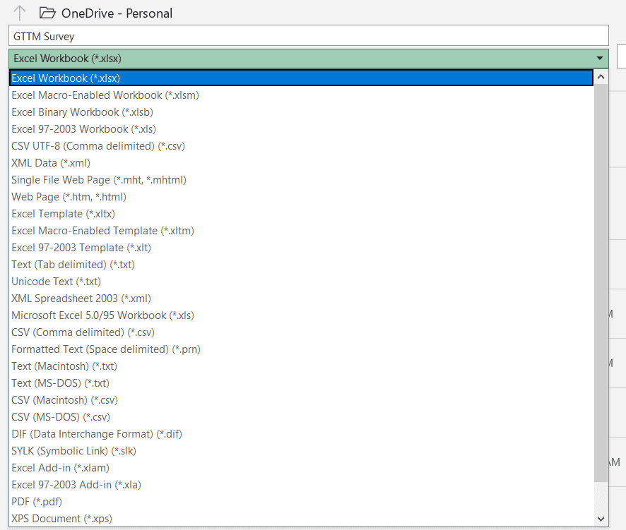

This is a guess, not verified. If you use Save-As in Excel and save the file in an earlier Excel format, or a portable format, you could re-read the new file into Excel and edit without the lock.
Thanks for the suggestion, anorlunda. I will check it out.
