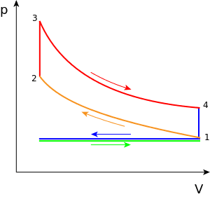

The HHO enthusiasts believe that adding HHO to the air-fuel mix causes combustion to proceed much faster,
making the engine more closely resemble an ideal OTTO cycle with constant volume combustion segment 2-3.
from https://en.wikipedia.org/wiki/Otto_cycle
PV diagram of an Otto-type cycle with labelled points 1 to 4 on a p-V plot, showing constant-volume segments 2-3 and 4-1 and a compression curve.
The processes are described by:
  • Process 0-1 a mass of air is drawn into piston/cylinder arrangement at constant pressure.
  • Process 1-2 is an adiabatic (isentropic) compression of the air as the piston moves from bottom dead centre (BDC) to top dead centre (TDC).
  • Process 2-3 is a constant-volume heat transfer to the working gas from an external source while the piston is at top dead centre. This process is intended to represent the ignition of the fuel-air mixture and the subsequent rapid burning.
  • Process 3-4 is an adiabatic (isentropic) expansion (power stroke).
  • Process 4-1 completes the cycle by a constant-volume process in which heat is rejected from the air while the piston is at bottom dead centre.
  • Process 1-0 the mass of air is released to the atmosphere in a constant pressure process.
Combustion would ideally take place at top dead center
in reality it starts maybe 30 degrees before and continues well after.. Their approach is to add HHO until the engine's knock sensor detects early combustion and retards the spark.
I understand the premise. It's not perpetual motion, just moving a real cycle closer to ideal..
But I remain skeptical as to practicality. Seems to me a mix with enough HHO in it to do any good would backfire terribly. Indeed a friend of mine blew up his intake manifold.
old jim
The latter.The combustible HHO added to the fuel-air mix is supposed to speed up flame propagation outward from the sparkplug.
That left edge of the OTTO cycle is curved in a real engine because combustion isn't instantaneous, they're hoping to square it up a bit.
Knock sensor keeps it from wrecking the engine.
