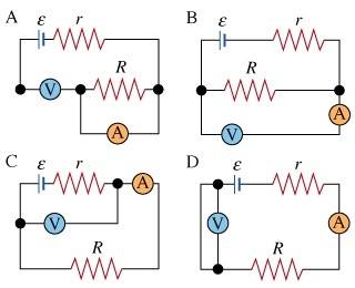

In which diagram(s) (labeled A - D) does the ammeter correctly measure the current through the battery?
I know that ammeters measure the current in series, and that the voltmeter won't have any effect on its reading, but I'm confused about the digram A
I would say that its image A and D, but I'm not sure how A would work
any help would be appreciated guys !
  • Four circuit schematics labeled A to D, each with a battery (emf), internal resistance r, resistor R, a voltmeter V and an ammeter A placed in different positions.
ok assuming that the voltmeter and ammeter are ideal. The voltmeter will have infinite resistance. What does that mean for a current passing through the voltmeter?
ahhh, it'll go down to zero ...thanks !
one more thing, when will the voltmeter read zero ?
i'm thinking since it measures potential between two points it will be zero wherever there is a clear path between the two points: "D" ... sounds right ?
