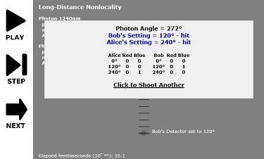

Hi There. I am in the process of building an animation to match your parameters in post #2. The steps for a given event are:
1. Generate a photon with a random polarization angle between 0 and 360
2. Split the photon with a BBO crystal and point at Bob and Alice
3. Set a random polarization angle of 0, 120 or 240 to each of Bob and Alices's detector
4. Record if a photon is detected and send a 2 x 3 matrix of numbers to Yvonne
For the detection event, at this time I am using the classical description of the photon used by Dehlinger and Mitchell in http://arxiv.org/PS_cache/quant-ph/pdf/0205/0205171v1.pdf. When a photon meets a polarizer set to an angle γ , it will always register as Vγ if λ is closer to γ than to γ + π/2, i.e.,
  • if |γ − λ| ≤ π/4 then vertical
  • if |γ − λ| > 3π/4 then vertical
  • horizontal otherwise.
At this point I am not sure what to put in the matrix? You can see an example of a run below where a 272° photon is shot, Bob sets his detector to 120° and is hit, likewise Alice sets her detector to 240° and is hit. What should their respective matrices they send to Yvonne look like?
Animation at: http://www.animatedphysics.com/games/photon_longdistance_nonlocality.htm
The NEXT button (not done yet) will generate a continuous stream of these events.
Thanks.

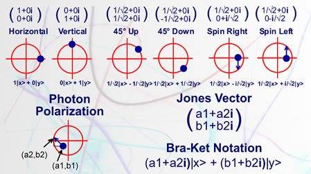

What about photons that have passed through a vertical filter? These photons will pass through a second vertical filter 100% of the time and will never get through a horizontal filter. All other angles have an element of randomness.
After some thought, perhaps a clarification. I mean a vertical photon with a Jones Vector labeled vertical in the diagram below.
##E=0##, ##F## will have 3 zeros and a 1 in the position corresponding to the color of the lights seen.
In a continuous run you start with all matrices initialized with zeros, and (assuming for simplicity that all events are valid and paired) after each such event add a 1 to the correct entry in both ##A## and ##B##, and a 1 to the correct entry in either ##E## or ##B##, depending on the pointer settings. You also count the number of valid pair events. After the experiment is completed you divide all matrices by this number. This is the final result. (If there are errant photons and/or detector inefficiencies you need a more sophisticated updating procedure, as you need to make sure that each matrix only counts the valid signals. In this case you need to make three counts, one for Alice alone, one for Bob alone, and one for Yvonne (who analyzes the complete results), and update the matrices only after enough time has passes so that one knows whether the signal was valid or spurious. Also, note that Yvonne's criteria for validity are more restrictive than those for Alice and Bob.
Your language is inviting misunderstanding.
If a photon goes through a polarizer producing vertically polarized light, the result is not a vertical photon but a vertically polarized photon.
  • #46
Thank you for the clarification, I will amend my comments.

... In a continuous run you start with all matrices initialized with zeros, and (assuming for simplicity that all events are valid and paired) after each such event add a 1 to the correct entry in both ##A## and ##B##, and a 1 to the correct entry in either ##E## or ##F##, depending on the pointer settings...
Thank you for your assistance, I believe the animation matches the specifications. It stops between each photon to show what each of the people is recording and it allows you to shoot additional photons to verify proper operation and build up a data set (continuous operation will come with the NEXT button, not yet done). Looking forward to use of the data to study "wierdness". At this point, I am still using the classical description of the photon used by Dehlinger and Mitchell in http://arxiv.org/PS_cache/quant-ph/pdf/0205/0205171v1.pdf. When a photon meets a polarizer set to an angle γ, it will always register as Vγ if λ is closer to γ than to γ + π/2, i.e.,
A sample run is shown below after 4 photon shots.
