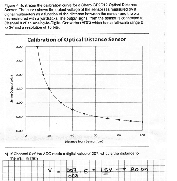

I was looking at a similar problem, and the solution used voltage.
If I calculated the problem below, using the method I used above, I would have had... 307/1023 * 90 = 0.27, so it wouldn't be correct according to that.
