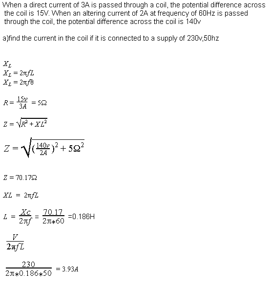

Hi ,so am currently doing homework , and was wondering if anyone could tell me if i have done my calculations correctly ,because am not 100% sure that i have answer to those 2 questions correctly .If i have went somewhere wrong if you could tell me where and how i could fix it ,that would be great. Thank you.
  • Handwritten-style typed worked solution on a coil problem: R = 15V/3A = 5 ohm, Z = sqrt((140V/2A)^2 + 5^2) = 70.17 ohm, L = Xc/(2 pi f) = 0.186 H, and V/(2 pi f L) = 230/(2 pi x 0.186 x 50) = 3.93 A.

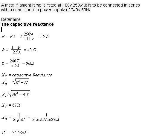

  • Handwritten-style worked solution typeset as equations: lamp rated 100V, 250W, current I = 2.5 A, resistance R = 40 Ω, impedance Z = 96 Ω, reactance Xc = √(96² − 40²) = 87 Ω, and C = 1/(2πf·Xc) = 36.58 µF at 50 Hz.
Your capacitive reactance answer looks good.

You are a bit more consistent than the examiner.
The questioner wrongly specifies lower case units, without a space; 100v, 250w, 50hz.
For units named after a person, such as Volta, Watt or Hertz;
the initial should be spaced and upper case; 100 V, 250 W, 50 Hz;
while the spelled out unit should be all lower case; 100 volt, 250 watt, 50 hertz.

Both answers contain typos.
The answer for the capacitor case looks ok, though I haven't check the arithmetic operations.
The answer for the coil contains too many typos and inconsistencies, for example you write that ##Z=\sqrt{R^2+X_L^2}## and then later you seem to imply that ##Z=X_L##.
Please rewrite the answer for the coil.

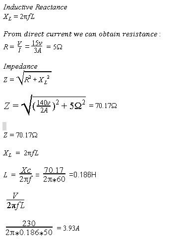

is this better ?
  • Handwritten-style typeset working showing inductive reactance XL = 2πfL, resistance R = V/I = 15V/3A = 5Ω, impedance Z = √(R² + XL²) = 70.17Ω, then L = Xc/2πf = 0.186H and I = V/2πfL = 3.93A.

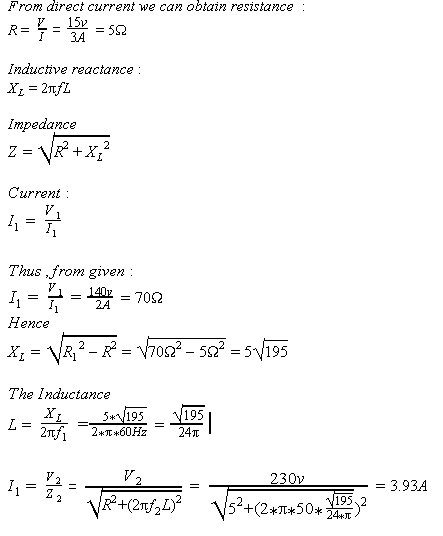

Nope you basically do the same mistake. The correct way to go is as follows:
The coil's impedance at 60hz is ##Z=\frac{140}{2}##. Use this and the equation ##Z=\sqrt{R^2+X_L^2}## to correctly determine the reactance ##X_L## at 60 hz and from that the value of L.
Then you should NOT forget the ohmic resistance of the coil when you calculate the new reactance and new impedance at 50hz

  • Handwritten-style typed derivation of coil inductance: R = 15V/3A = 5 ohms from DC, then X_L = 2 pi f L, Z = sqrt(R^2 + X_L^2), and I_1 = V_1/Z_1 with 140V/2A = 70 ohms, leading to X_L = 5 sqrt(195) and L = sqrt(195)/(24 pi) at 60 Hz, ending with I = 230V/sqrt(5^2 + (2 pi 50 L)^2) = 3.93 A.
