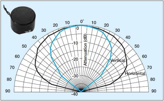

As @tnich says, they add linearly, but you need to take several other things into consideration:
  • The intensity of the waves decreases as they move away from the source transmitter
  • The intensity pattern of the transmitters varies with the angle from the axis of the transmitter (the intensity decreases with increasing angle off-axis)
  • Any pickup transducer you use will also have a similar "gain" pattern that falls off with increasing angle off-axis) -- it is difficult to make an isotropic transmitter or receiver for ultrasound.
Can you say more about the application? A typical pattern for Tx and Rx for an ultrasonic transducer is shown below...
http://www.newelectronics.co.uk/article-images/image-library/93/Fig5.jpg

CGandC said:
The theoretical system I've drawn is merely to achive a general idea so there's no specific transducer yet... I aim to create a simulation in MATLAB that will calculate the pressure/intensity at a point from a collection of transducers and will know the direction of the resultant ultrasonic wave.
Fair enough, sounds like a fun project. My main point was to use real-world transducer gain-versus-angle numbers from their datasheets if you want a simulation that will be accurate in real-world testing. It's a lot easier if you assume isotropic Tx and Rx, but that's not how it works in the real world. Have fun! :smile:
There are some "i"s missing in those exponential versions of the trig in post #4 but we recognise what you are proposing. If you want to calculate the pattern, it would be easier to stick to the Real part all the way through. (Just the cos's or sin's)
As @berkeman points out, because the transducers are not pointing in the same direction, you would need to modify that vector summation by the directivity patterns unless you are considering the area where all the transducer patterns are within about +/- 30 degrees.
If I were doing this exercise, I would be inclined to start off by assuming omnidirectional patterns to start with - just to get it working convincingly. To include the directivity could be a bit fiddly - more trouble than the initial calculation. To start with, I would perhaps place the transducers in a line. That would produce a very familiar pattern.
If this is to be followed by a real world version, the mounting boards could possibly introduce reflections from the 'other two' transducers. It may be necessary to use some absorbent coating to deal with that.

I just spotted that radiation pattern in @berkeman's post, earlier on. That refers to a radio antenna (dipole array), which produces different patterns in different planes because EM waves are transverse. Ultrasound waves are longitudinal so that's one problem you won't have. You can use the 'Horizontal' pattern which is based on point sized elements and is not influenced by the vertical pattern of each dipole. Even so, the half amplitude width is +/- 50° and a factor of a half for some contributions can be really significant to the pattern. So ignore this until you are confident your basic calculation gives convincing results.
