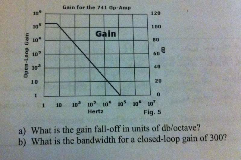

I have attached the graph, and questions.
For part a, do I just have to estimate how many db's are lost during one octave? One octave is halving of frequency, so could part a be approximated to be about 8 db/octave?
For part b, I'm not sure what to do, so any help is appreciated. Thanks

The plot you are given does not have very good resolution. I'd recommend that you google log-log graph paper, and re-draw the plot on that paper. That will give you the resolution to be able to answer the questions.
Are you suggesting I print it out and redraw it on a new sheet? Unfortunately, I don't think my drawing ability will be as good as the given, computer-generated plot. Is there no way to use the one I uploaded? Thanks.

I dunno. The graph provided seems to give a pretty good indication that there's a drop of 100 dB over 4 decades. dB/decade ≈ 3.322 db/octave. The "3.322" comes about as the ratio of the logs of the bases -- log(10)/log(2).

As far as how you got that number 3.322, I'm still a bit unsure about how it was attained. I agree with the 100 dB over 4 decades, so why wouldn't it be 25 instead of 3.322?

3.322 is not the answer. It's the scaling factor that relates dB/decade to dB/octave.
dB's are logs of ratios. Over a decade, the frequency changes by a factor of 10. Over an octave it changes by a factor of 2. log(10)/log(2) = 3.322. You can take the logs in any base you wish, and the ratio of them will be the same: ln(10)/ln(2) = 3.322.
Ohh. So since the dB/decade is about 25, I would have to multiply that by 3.322 to get the ultimate gain fall-off in terms ofdB/octave?
Try dividing. A decade contains several octaves. dB/decade ≈ 3.322 db/octave so that db/octave ≈ (db/decade)/3.332.
Ahh right. So about 7.5 db/octave. My initial rough estimate was fairly close. Great.

The Gain-Bandwidth product should come in handy for part b. You can read its value right off your plot, and use it to determine the closed-loop bandwidth for the required gain.
Have a look http://www.analog.com/static/imported-files/tutorials/MT-033.pdf" .
It says the closed-loop bandwidth is equal to gain bandwidth product divided by noise gain. Would the gain-bandwidth product just be 100? I'm not sure how to get the noise gain in this case though.
The gain-bandwidth-product is equal to the unity-gain-bandwidth, which is equal to the frequency where the open loop gain is unity (1 x freq = freq). Your graph crosses the zero dB line at 105 Hz. So that should be your UGBW.
The NG, or "noise gain" is just nomenclature for the closed loop gain.
Now, you want a closed loop gain of 300. So 300*BW = UGBW. BW = 333.3 Hz.
