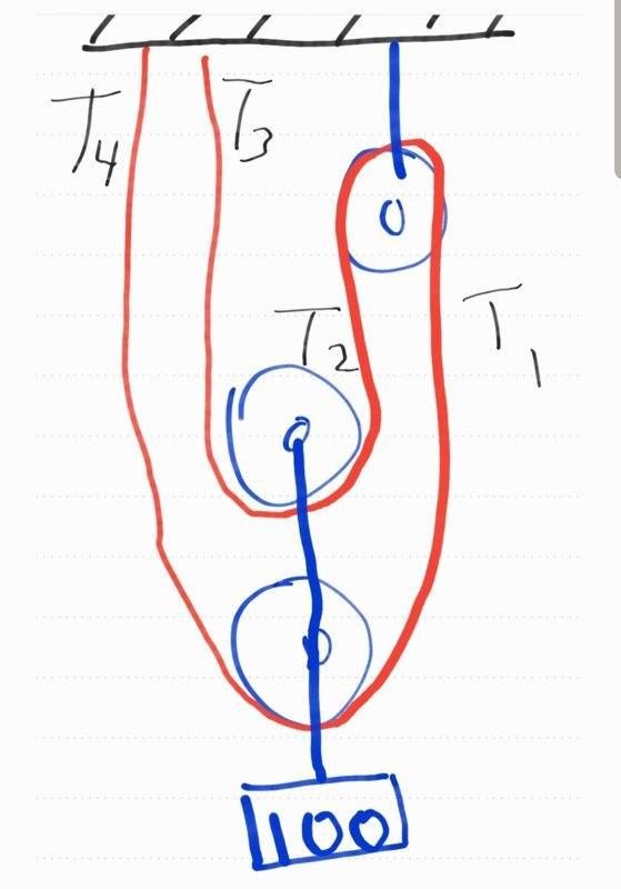

How will the tensions/load be distributed between each wire section (4 sections)?
Not sure
I asume the upper right pulley wire loads will be split in two equally. Therefore, the sum of the loads above pulley equal T1+T2?.
To me it appears as if the setup is almost like a 2 to 1 ratio. However, the wires on the left side which are anchored, split the load of the other half of the 2 to 1 (half of half).
Therefore, top right pulley (T1+T2 = 50lbs)? T3=25lbs? T4=25lbs?
How would I see this mathematically solved using vector notation?
Note that the bottom pulleys are bonded together.

Your help would be appreciated. I am so confused.

Suppose that, e.g., T2 and T3 are not equal. What would happen to the middle pulley?

What happens when you apply opposing but unequal torques to an object that is free to rotate?

Forget the current problem for a moment. If a rope goes around a pulley (which is free to rotate) and the tensions are different in the two sections of rope, what will happen? Think about torque.

I believe the pulley shall torque or "rotate" freely towards the leg/section that has the highest tension?

So what does that tell you about the tensions in your diagram?

Take T2 and T3 for example. As you stated, if they are not equal then the pulley they both connect to will rotate. Does it?

In this case I believe NO. However, if there was slack YES until it stops or becomes static. The pulley torques I would imagine remains.

You can safely assume it is now static.
So what can you say about T2 and T3?

T2 and T3 equal each other?

Right.
What about all the other tensions?

All tensions are equal. Each leg is a 1/4 of 100LB load?
Yes..
