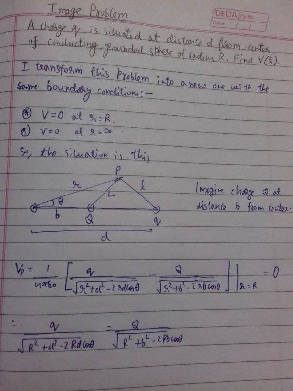

A charge q is kept at distance d from center of grounded conducting sphere of radius R. Find V everywhere outside.
V = k*q/r
Cosine Law.
[/B]
What do I do with the theta?
And how would I analytically find out what Q and b are?
Sorry, I don't know how to use LaTeX...
V = k*q/r
Cosine Law.
[/B]
Just multiply out as necessary to get rid of the square roots and fractions and see what values make theta disappear,
Theta is one of the two independent variables for P. The distance betwwen P and Q and P and q are functions of theta as well as r.
Post 2 tells you that. Or you can cheat by googling :smile: It's widely disseminated.
Note that you find b and Q by eliminating theta but the expression for the potential itself must include theta.

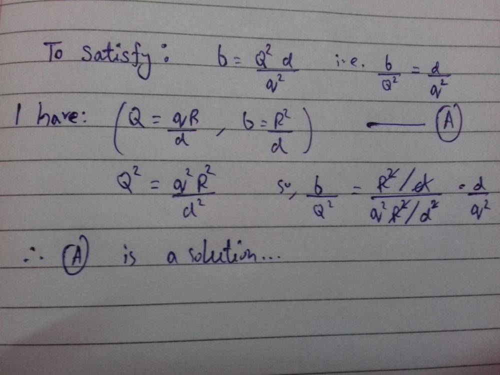

So I solved it and got this:
b=Q2*d/q2
So this is a parabola! And all points on this must satisfy the condition for 0 potential at surface of sphere... isn't it?
Griffith's has taken one solution
Q= qR/d
b= R2/d
But I can take other solutions too, can't I?
Kaguro said:
Ok!
b=Q2*d/q2
Q= qR/d
b= R2/d
In fact, you'd better since the equation for Q is wrong! (Maybe typo.)
Ummm... why?
Are you talking about minus sign?
Yes.
Bear in mind that when you square to get rid of a square root you double the number of solutions of your equations.
Also, there is a trivial solution, Q=-q, b=d, which gives a zero potential everywhere.
Combining those, you will have four solutions, only one of which is nontrivial and satisfies the actual problem.
