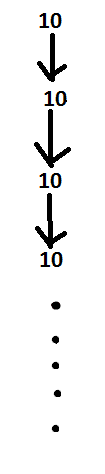

I tried to make the recursion-tree like that:
Is it right? If so, does it take the last value, for $N=1$, since then $\lfloor \frac{N}{2} \rfloor=0$ ?
Are there $\log N+1$ levels?
Or am I wrong? (Worried)

evinda said:
So, when we have for example this algorithm:
the recurrence relation is:
$$T(n)=\left\{\begin{matrix}
T\left( \lfloor \frac{n}{2} \rfloor\right)+10 &,n \geq 1 \\
2 &,n=0
\end{matrix}\right.$$
Does $T(n)$ denote time? Then why would we use it for memory? I don't see how numbers like 10 and 2 from the definition of $T$ have anything to do with memory.
Without defining the recursion tree it does not make much sense to discuss how it looks like. What can be discussed precisely is the number of recursive calls made when [m]BinarySearch[/m] is called with arguments $\mathit{low}$ and $\mathit{high}$. (I stated it incorrectly in the previous post: the maximum number of iterations/recursive calls depends on $\mathit{high}-\mathit{low}$, not on $n$.) And yes, it is around $\log_2(\mathit{high}-\mathit{low})$ (whether exactly, +1 or -1 or something like that requires a more careful look).
Coud you explain me further how you concluded that the memory, that is required, is around $\log_2(\mathit{high}-\mathit{low})$ ? (Thinking)
