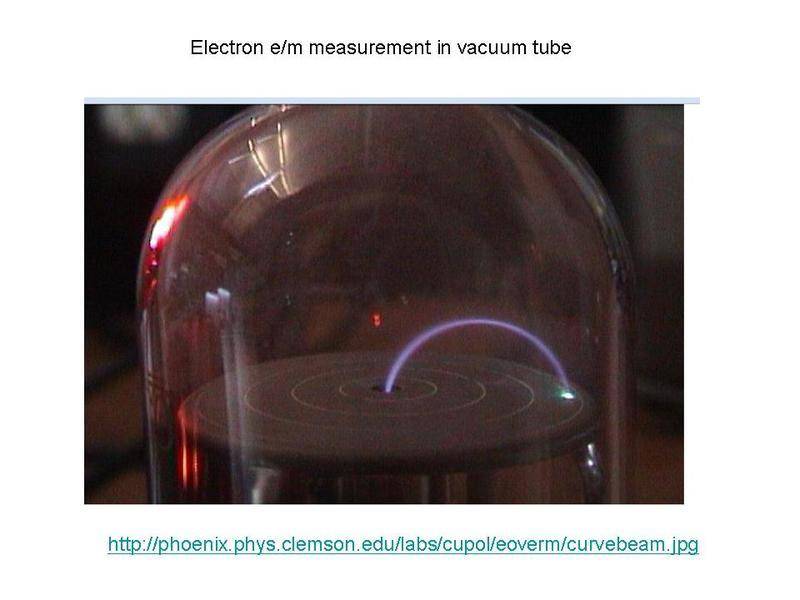

The force on a length of wire L carrying a current I in a magnetic field B is given by the Lorentz force equation
F = L(I x B)
where I x B is the vector cross product of I and B, and has a magnitude I·B sin(θ), where θ is the angle between I and B, and the force is perpendicular to the plane including both I and B. For an elegant physics lab demonstration of this force, see
https://www.physicsforums.com/attachment.php?attachmentid=22954&d=1263085690
This photograph shows a 300-volt electron beam in a vacuum tube being deflected by a magnetic field in a Helmholtz coil.
