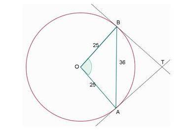

Hi everyone, I need further explanations about the answer of this problem.
The answer is angle T = 87.9 degrees.
Thanks.

Use the cosine rule to evaluate the angle on the origin of the circle.
Radii and tangents to a circle are always perpendicular.
Once you realize this, you have three angles in the quadrilateral OBTA. The angle sum of a quadrilateral is 360 degrees. You should be able to evaluate angle T from there.

Prove It's method is more succinct, but here's an outline of what I did:
1.) Bisect $\triangle ABO$ and use the Pythagorean theorem to find the altitude.
2.) Use the law of sines to find $\angle OAB$.
3.) Use that fact the a tangent to a circle and a radius to the tangent point are perpendicular to find $\angle BAT$.
4.) Use the fact that $\angle BAT=\angle ABT$ and the sum of interior angles of a triangle being $180^{\circ}$ to find $\angle BTA$.
5.) Use the fact that $\angle BTA+\angle T=180^{\circ}$.
You should find $$\angle T=180^{\circ}\left(1-\frac{2}{\pi}\arccos\left(\frac{\sqrt{301}}{25}\right)\right)\approx87.89^{\circ}$$
