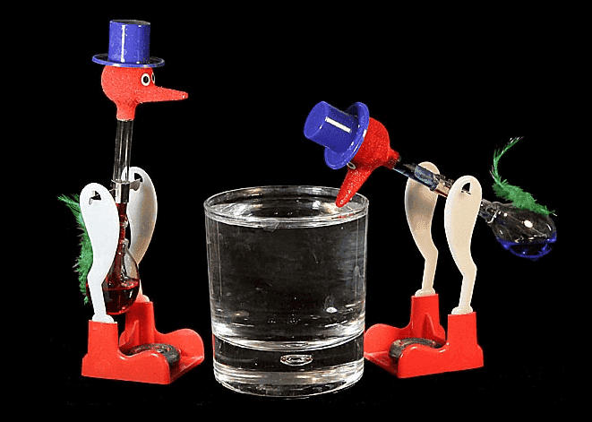

Agreed. After lots more personal research on my part, I think I've decoded the OP's question...
http://waynesthisandthat.com/birds.html
