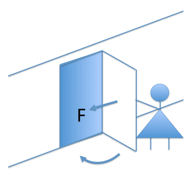

1. Homework Statement
A door of width l = 1.00 m and mass M = 15.0 kg is attached to a door
frame by two hinges. For this problem, you may ignore gravity, as we are
interested in rotational motion around the vertical axis. There is no friction
of any kind.
An angry mother-in-law slams the door shut, by pushing at the middle of
the door (l=2 from the hinges) with a force of F = 100N, lasting a time
t = 0:.00 s. The door is initially not rotating. The door can be taken to be
a uniform rod, for the purpose of this exercise.
a) What is the angular acceleration of the door while it is being pushed?
b) What is the resulting angular velocity, angular momentum and rotational
kinetic energy from this push?
c) Assuming that she let's go of the door (leaving it to slam shut) at the
moment in the motion when the door is perpendicular to the wall, how long
does it take for the door to close?
d) What would be the result of a), b), c) and d) if she had pushed not in the
middle of the door but at the edge (l from the hinges)?
In addition to the force of the mother-in-law, the hinges also provide force,
both radial (centripetal) and tangential force while the mother-in-law pushes
(they also compensate for gravity to keep the door upright, but ignore that
for now).
e) Combining angular acceleration and linear acceleration considerations, find
the tangential force Fh supplied by the hinges as a function of d, the distance
between the hinges and the point of application of the mother-in-law force
(d was l=2 in part a) and b), and l in part c); now use a general d). Don’t
put in explicit numbers, just find the equation.
f) For which d do the hinges not need to provide any tangential force?
Can someone check on my solutions, All answers appreciated![/B]
a)
τ= l/2*F=50
τ=M*(l/2)^2*α
α=τ/M*(l/2)^2= 13.33 rad/s^2
b)
ω=ωi+αt=2.7 rad/s
I=(1/12)*Ml^2=1.25 kg*m^2
L=I*ω=3.375 kg*m^2/s
K=(1/2)*I*ω^2=4.56 J
c)
θ=θ+ωt+(1/2)αt^2
π/2=2.7t+(1/2)13.33t^2
used the abc rule
t=0.323 s
d)
τ= l*F=100
τ=M*l^2*α
α=τ/M*l^2= 6.7 rad/s^2
ω=ωi+αt= 1.34 rad/s
I=(1/3)*Ml^2=5 kg*m^2
L=I*ω=6.7 kg*m^2/s
K=(1/2)*I*ω^2=4.489 J
θ=θ+ωt+(1/2)αt^2
π/2=1.34t+(1/2)6.7t^2
used the abc rule
t=0.512 s
e)
This solution i am sure is wrong
Fh(d)= τ(d)/I + F(d)/M

It appears that you have some typos in the statement of the problem
I assume she pushes the door at a point located L/2 from the axis of rotation. (Lower case L should be banned as a variable.)
The time interval over which she pushes is not given. It looks like you used t = 0.20 seconds.
What did you use for the moment of inertia of the door ?
... and about what axis?
Haveagoodday, you seem to have used ML2/4 in a) and ML2/12 in b).
I have same answers in a and b, but you have a typo in b. In c you have to calculate again, your answer is wrong.

None of the answers given to a) and b) in the OP are correct.

This is rotation. Use torque and moment of inertia.

Better, but as Sammy pointed out in post #2 the L=2 must be a typo, probably for L/2. Does that change your answer?

Then you are probably using the wrong moment of inertia formula. What did you use?

i now got 40 in a
and 8 rad/s, 10 kgm^2/s, 40J in b
are these answers correct?
And what equations can i use in c?
Haveagoodday said:
i now got 40 in a
As I implied in post #15, I get a different answer. Please post your working.

in a:
I=Ml^2/12=1.25
α=T/I=40
in b:
w=w+αt=8
L=Iw=10
K=Iw^2/2=40

What is the acceleration in part c?

Where is the axis of rotation?
is it the y axis, or?
haruspex said:
Where is it in relation to the door?
it is in relation to the height of the door?
No, it's vertical. In relation to the width.
Ok, but how does that make my result wrong?
You're not answering my question. Where is this vertical axis in relation to the door's width? Does it run up the middle of the door?
