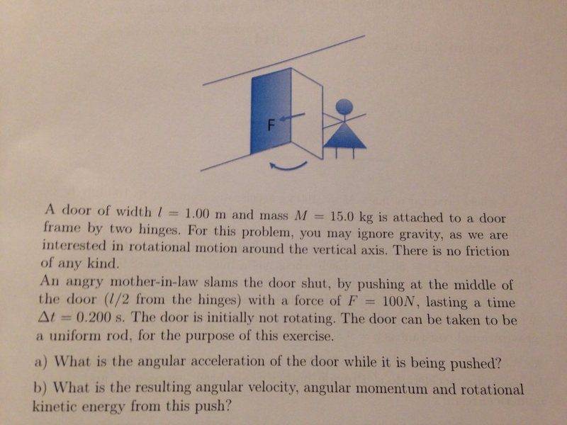

You're not answering my question. Where is this vertical axis in relation to the door's width? Does it run up the middle of the door?
I got 10 in a)...Inertia formula that i have used is: I=(ML^2)/3...The question says that we should consider the door as a uniform rod, hence the formula that i have chosen to use...Please correct me if I'm wrong
That's it.

On c.) could the time be 2,53s (also got t= -1,26), used abc formula with α=10 and ω=2? Used the inertia formula that StavangerFinest did: I = (ML^2)/3.

I got t= 0,40s...What did you use as θf and θi?

The time to close is less than 2 s but more than StavangerFinest's 0.4s.

I did it again and i get 0,79s... Assistants told me I shouldn't have used abc formula but a simple t= Δθ/ Δω...
Can you help me with question e) and thereby f) in this exercise though? I got in f) that
d= 2L/3 (two thirds of L)
pretty insecure abt this one

I am stuck on e). What I have done:
T = d x F x sin(theta)
T = I x alpha
I x alpha = d x F x sin(theta)
F (d) = (I x alpha) / (d x sin (theta))
F (d) = (1/3 m x d^2 x a) / (d^2 * sin (theta))
But then all my d's disapear... Am I on the right track?

I used tetha final to be pi/2 and tetha initial to be 0, and abc formula with alpha=0, got 0,79s then :)

Sorry, have been busy. I still have 40 in a . Alpha =( ΣF*L/2)/ (1/3*M*(L/2)^2) is my formula. Since it is a uniform rod with an axis through the end and the push is in the middle... I saw answer 10 somewhere... So now I'm puzzled

After MIL (mother-in-law) releases the door, its angular velocity is constant. The time interval during which she applies force is fixed at 0.2 seconds (we think so anyway - no confirmation from Haveagoodday )​

Is it true that the time of contact with the door is 0.2 seconds? (or as some write: 0,2 seconds)

Well, it looks like a typo to me in the statement of the problem, as was the l=2 rather than l/2 .
Haveagoodday said:
An angry mother-in-law slams the door shut, by pushing at the middle of
the door (l=2 from the hinges) with a force of F = 100N, lasting a time
t = 0:.00 s.

you are using the wrong value of l, you have to put in the total width of the door in the equation, it doesn't matter where she pushes the door, it only matters when calculating the torque.

yeah, i recalculated and got 0.785s.

Θf=Θi+ωi*t+0.5αt^2
90=0+2t+0.5*10t...and the result is far of the one you say is correct...
  • #58
coffeemanja said:
Can I post mine?
Θf=Θi+ωi*t+0.5αt^2
you have to use this equation t= θf-θi/wf-wi
and you also have to use radians instead of degrees.
