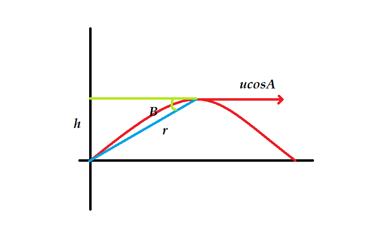

Find out the angular momentum of particle as it reaches the highest point about the origin in projectile?
m=1 kg angle(i)=60 degree(with horizontal) u=10 m/s g=10
As angular momentum=##mrvsinB ##
Here velocity at top=##ucos\theta ##
As sinB=h/r
h=rsinB
Now h=##\frac { { u }^{ 2 }{ sin }^{ 2 }\theta }{ 2g } ##
So angular momentum=##\frac { { u }^{ 2 }{ sin }^{ 2 }\theta }{ 2g } ## ##mucos\theta ##
On putting values I got
##\frac { 100{ sin }^{ 2 }(60) }{ 2\times 10 } 10cos(60)##
##5{ sin }^{ 2 }(60)10cos(60)##
##\frac { 15 }{ 4 } \times \frac { 10 }{ 2 } =18.75##
But the answer is 187.5
[/B]
  • Diagram of a projectile arc from the origin to the highest point, with the horizontal velocity ucosA drawn as a red arrow, a green horizontal line at height h, and a blue line r from the origin to the apex with angle B marked between them.
Your answer looks correct. Perhaps a typo in the problem statement or answer sheet.
Thank you Doc Al.
