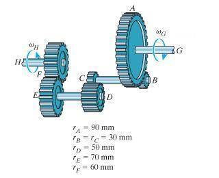

1. Homework Statement [/b]
The operation of “reverse” for a three-speed automotive transmission is illustrated schematically in the figure.
If the shaft is turning with an angular velocity of Wg= 30 rad/s, determine the angular velocity of the drive shaft H. Each of the gears rotates about a fixed axis. Note that gears A and B , C and D , E and F are in mesh. The radius of each of these gears is reported in the figure.
velocity=w * r (w is angular velocity)
"C:\Users\apoorva\Pictures\gears.jpg"[/URL]
[h2]The Attempt at a Solution[/h2]
So the angular velocity of shaft G is 30 rad/s.
I know that the velocity of B and A are same.
V[SUB]g[/SUB]=30(0.09)=2.7 m/s=V[SUB]a[/SUB]
W[SUB]a[/SUB]R[SUB]a[/SUB]=W[SUB]b[/SUB]R[SUB]b[/SUB]
2.7/0.03=90 rad/s =Wb
angular velocity of W[SUB]b [/SUB]and W[SUB]c[/SUB] is the same--> 90 rad/s
V[SUB]c[/SUB]=V[SUB]d [/SUB]so W[SUB]c[/SUB]R[SUB]c[/SUB]=W[SUB]d[/SUB]R[SUB]d[/SUB]
90(.3)=W[SUB]d[/SUB](.05)
W[SUB]d[/SUB]=54 rad/s
W[SUB]d[/SUB]R[SUB]d[/SUB]=W[SUB]e[/SUB]R[SUB]e[/SUB]
54(.05)=W[SUB]e[/SUB](.07)
W[SUB]e[/SUB]=38.6 rad/s
W[SUB]e[/SUB]R[SUB]e[/SUB]=W[SUB]f[/SUB]R[SUB]f[/SUB]
38.6(.07)=W[SUB]f[/SUB](.06)
W[SUB]f[/SUB]=45.03 rad/s
Therefore W[SUB]h[/SUB]=45.03 rad/s
But I keep getting the answer wrong and I don't know what I am doing.
  • Schematic of a three-speed reverse gear train with gears labelled A to F and shafts labelled G and H, with angular velocity arrows ω_G and ω_H; listed radii r_A = 90 mm, r_B = r_C = 30 mm, r_D = 50 mm, r_E = 70 mm, r_F = 60 mm.

I think I can help you out. I think you need to use gear ratios.
The speeds of gears can be determined by their gear ratio
If a particular gear moves at say 30 rad/s and has a radius of 4 and that same gear moves another with a radius of 6 than you can find the speed of the second gear by using a ratio
Gear ratio = Radius of larger gear/radius of smaller gear
In this case the gear ratio would be 1.5:1. This means that whenever the first gear rotates 1 and half times the second gear rotates only once.
how did you get 1.5:1. is from using your numbers or the radius from my problem?
Ok, looking from my problem
Shaft G is 30 rad/s and gear A has the same angular velocity because the shaft is connected to gear A. Radius of gear A is 0.09 meters.
The second gear is B and it's radius is 0.03.
Gear ratio=0.09:0.03 which is 3:1, right?
then I would use that to find my velocity?
So speed of Gear B is=30(3)-->90 rad/s.
Then Gear B and Gear C are the same because the radius is the same.
So Gear C has 90 rad/s which has a radius of 0.03m.
Gear D has 0.05m.
Gear ratio=0.05:0.03--> 1.67:1
then speed of Gear D is (1.67m)(90)=150
..etc.
right. that's the idea?

Well if 90mm is 3 times as big as 30mm than that is a ratio of 3:1. Likewise if a gear is .05m and the other is .03m than it is a 5:3 ratio. a 5:3 ratio is the same as a 1.67:1 ratio mathematically.
What book are you using? Are using Engineering Mechanics: Dynamics (12th edition) by Hibbeler because if you are then Wg is incorrect. it should be 60rad/s not 30rad/s.
