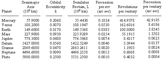

You may find this helpful
from http://mathpages.com/rr/s6-02/6-02.htm
Edguy99, the table you listed gives the predictions from GR. Observations are listed farther up on the same web page.
