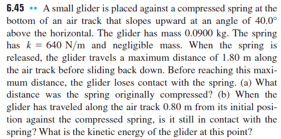

Below is the question:
Textbook problem 6.45 about a glider launched by a compressed spring up a sloped air track at 40.0 degrees, with mass 0.0900 kg and spring constant 640 N/m, asking for the initial compression and the glider's kinetic energy at 0.80 m.
My equation for Work Total is:
Delta PE = Wspring + Wgravity
However, the solution key says that the Wspring + Wgravity = 0
I fail to understand this, why is the total work zero when there is a change in potential energy?
  • Textbook problem 6.45: a glider pressed against a compressed spring on an air track inclined at 40.0 degrees, with mass 0.0900 kg, spring constant 640 N/m, and travel of 1.80 m before sliding back.
[edit: better way to say it]
If you come up with both gravitational PE and another total PE, you end up with more energy than the spring put into the system. You're counting the GPE twice.
