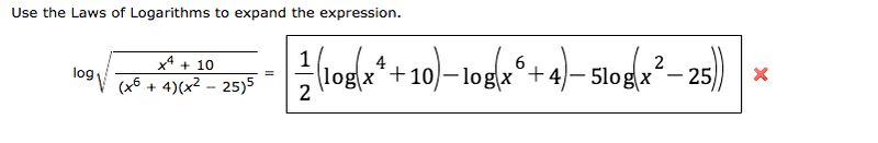

Any ideas why this law of logs problem is marked incorrect?
The discussion centers on the mathematical expression ##\log(x^2-25)## and its validity under certain conditions. Participants clarify that the expression is defined for all ##x## such that ##|x|>5##, while ##\log(x-5)## is only valid for ##x>5##. This distinction is crucial as it explains why the expression cannot be rewritten as ##\log(x+5)+\log(x-5)## without losing its original domain. The incorrect marking of the answer may stem from an automated system misinterpreting the notation used.

Niaboc67 said:
Thanks
It is correct, but you can expand x2-25 further. And note that |x|>5
so instead of 25 it would be 5?
What ehild means in the last sentence is that you must have |x| > 5.
No, what he's saying is that you can factor x2 - 25.
I also meant that the expression is not defined for |x| ≤ 5. You have to exclude it. And when expanding x2-25, log(x-5) is only defined if x>5,
The original expression is defined for all ##x## such that ##|x|>5##. (These values of ##x## make the thing under the square root positive). But ##\log(x-5)## is defined for all ##x## such that ##x>5##. So ##\log(x-5)## isn't defined for all ##x## such that the original expression makes sense. This seems like a good reason to not do the rewrite ##\log(x^2-25)=\log(x+5)+\log(x-5)##.
Yes, the expression can not be really expanded further for all x. Why was it marked incorrect then?
I'm guessing it is an online system which the answer is typed into, and automatically marked... So maybe it is because the 5 was placed right before the log, as in
5log, and maybe the computer did not recognize this as 5*log ?
I understand now. The x-25 could have been factored more. Thanks guys!
Just to be clear, that should be x2 - 25.
The ##x^2-25## can be factored, but we also said that it shouldn't be, because you don't want a final answer that makes sense for a smaller set of values of ##x## than the original expression. For example, the original expression makes sense when ##x=-7##, but an expression that contains ##\log(x-5)## doesn't. So we don't know why the answer you posted was marked incorrect. See BruceW's post for a possible reason.
