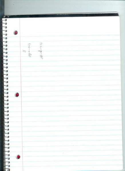

A 3.00-KG mass and a 10.0-KG mass are attached to opposite ends of a massless cord which is strung over a frictinoless pulley.
a) What is the acceleration of the two-mass system?
b) What is the tension in the cord?

I tried to draw a free body diagram of the two objects as one system, subtracting the least massive object from the most massive object (10 kg minus 3 kg). I then found the Fg of the system and used it to find the acceleration, then found the tension force using the acceleration found. According to the answer key, I am off, could anyone please show me the light?
Once you draw the free body diagram, write down force equation (net force = mass*acceleration) for each of the bodies, separately. Then you can solve for acceleration.
Welcome to PF
please can you post your FBD's?
just a rough drawing will work
i know what is atwood machine and i understood he ques.
i just want to make sure that is FBD's are right

I apologize for replying so late but here's the FBD.
Thank you!
I reworked the problem and set it up your way and I found the correct solution.
Thank you guys, it was really helpful.
