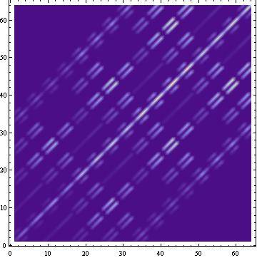

I wrote a Mathematica code to calculate the time dependence of states of a simple system where a massless Klein-Gordon field is constrained to have only modes corresponding to momenta ##p_1 = -1##, ##p_2 = 0##, ##p_3 = 1##. (the momenta are in natural units) Each mode is possible to be excited at most 3 times. Therefore the hilbert space of the system is ##3^3 = 27## - dimensional.
To the noninteracting hamiltonian ##H_0 = a_{p1}^\dagger a_{p1} + a_{p3}^\dagger a_{p3}## I add the ##\phi^4## interaction that consists of terms like ##a_{p1}a_{p2}^\dagger a_{p3} a_{p2} ##. (I made a C++ program that automatically writes the Mathematica code for all possible momentum-conserving terms like that)

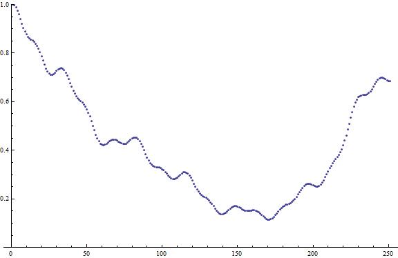

Then I use these definitions to calculate the quantum autocorrelation function of the vacuum state ##\left|0\right>## : ##C(t)=\left<0\right|U(t)\left|0\right>##.
Here ##U(t)## is the time evolution operator of the system.

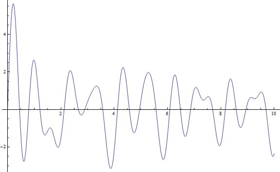

Code:
state = Table[Abs[vacuum.MatrixExp[-I*t*H/50].vacuum]^2, {t, 0, 250}]
ListPlot[state, PlotRange -> {0., 1}]
The plot of the autocorrelation function looks like this:
Mathematica plot of a curve over x from 0 to 250, starting at 1.0 and falling with small wiggles to a minimum near 0.12 around x = 170, then rising to about 0.7 near x = 245. Blue dots mark the points.
This plot looks like it is some kind of complicated function that has many sine and cosine components of different frequencies... I was expecting something simpler.

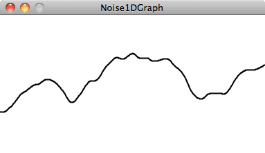

Yes, there is no mathematical way to generate genuinely "random" noise, anyway. All random number algorithms generate only pseudorandom numbers. What I'm saying is that the distribution of Fourier frequencies and amplitudes in those autocorrelation functions seems to be similar to that in fractal noise functions such as this in the image below:
Screenshot of a window titled Noise1DGraph showing a smooth, wavy black curve of 1D Perlin-style noise rising and falling across the width of the plot.
For instance, if I use mathematica to generate a random sine series with frequencies uniformly distributed on the interval [0,10] and amplitudes distributed on [0,1]:
Code:
f[x_] = Sum[RandomReal[{0, 1}] Sin[RandomReal[{0, 10}] x], {n, 0, 10}]
Plot[f[x], {x, 0, 10}]
I get a plot like this:
Plot of an irregular oscillating curve against x from 0 to 10, with peaks and troughs of varying height and spacing, the largest near x = 0.
which has an appearance completely different from either that vacuum state autocorrelation function or the perlin noise function.

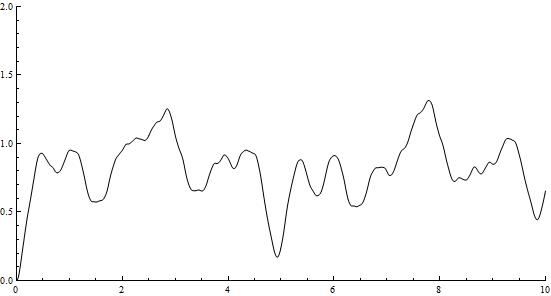

I made some more plots of the absolute squares of vacuum autocorrelation function ##|C(t)|^2 = |<0|e^{-iHt}|0>|^2## and
the expectation value of the particle number operator ##<N>(t)=<0|e^{iHt}Ne^{-iHt}|0>## for different numbers of momentum
modes and excitations available for each mode. All the plots are for the time interval ##0<t<10##.
3 modes, 3 excitations (##p_1 = -1##, ##p_2 = 0##, ##p_3 = +1##):

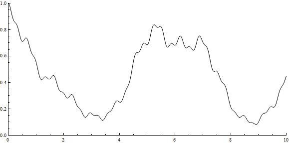

AutoCorr = Table[{t/200, Abs[vacuum.MatrixExp[-I*t*H/200].vacuum]^2}, {t, 1, 2000}]
Graphics[Line[AutoCorr], PlotRange -> {{0, 10}, {0, 1}}, Axes -> True]
NumberOp = Table[{t/200, Re[vacuum.MatrixExp[I*t*H/200].Numo.MatrixExp[-I*t*H/200].vacuum]}, {t, 0, 2000}]
Graphics[Line[NumberOp], PlotRange -> {{0, 10}, {0, 3}}, Axes -> True]

Plot of the absolute square of vacuum autocorrelation function:
Line graph of a function over 0 to 10 on the horizontal axis, 0 to 1 on the vertical axis: starts at 1, falls to about 0.1 near t = 3.5, rises to about 0.8 near t = 5.5, dips to about 0.1 near t = 9, then rises to about 0.45 at t = 10.
Plot of the expectation value of the particle number operator (at t=0 the system is in vacuum state and there are zero particles):
Line graph of a fluctuating curve against t from 0 to 10, rising from 0 to a peak near 2.5 at t around 2.6, then dropping to about 0.5 near t 5.4 and 6.9, and rising to about 2.2 near t 8 and 9.5.
Mathematica's density plot of the Hamiltonian matrix (the element (1,1) is in the lower left corner):
Density plot on a dark blue background showing bright diagonal streaks and off-diagonal blobs, with axes labelled 5 to 25 on both horizontal and vertical scales.

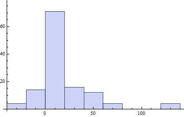

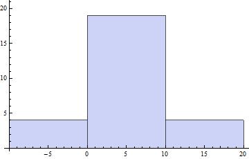

Histogram of the eigenvalues of the Hamiltonian matrix:
Bar-style plot of a step function: height 4 for x below 0, height 19 between 0 and 10, height 4 for x from 10 to 20, horizontal axis labelled from -5 to 20, vertical axis from 0 to 20.

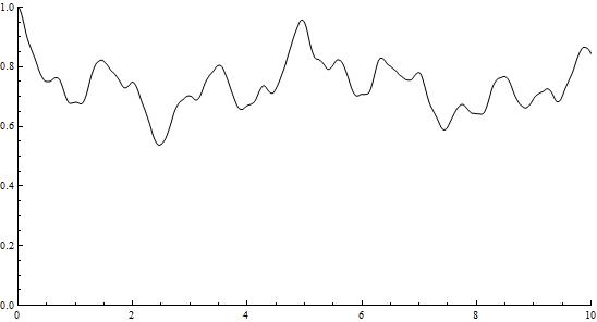

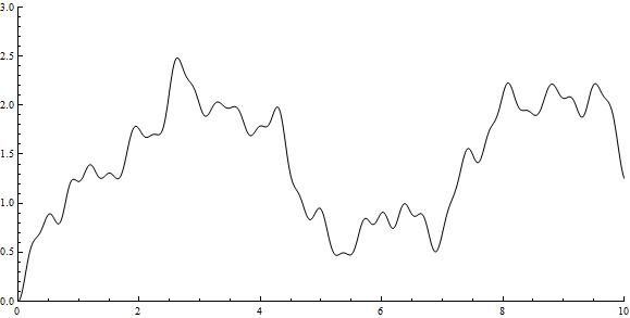

3 modes, 4 excitations (##p_1 = -1##, ##p_2 = 0##, ##p_3 = +1##):

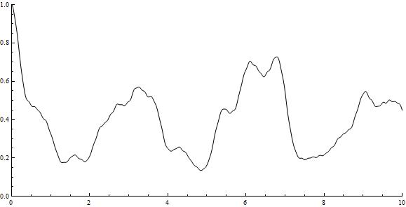

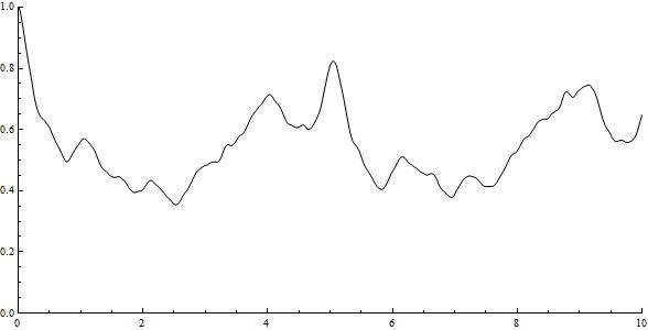

Line graph of a fluctuating curve against t from 0 to 10, with values between about 0.55 and 1.0 on the vertical axis, starting at 1.0 at t = 0.

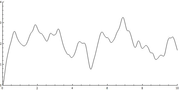

Plot of the expectation value of the particle number operator:
Line graph of a fluctuating curve against t from 0 to 10, with the vertical axis from 0 to 2.0, the curve rising from 0 and oscillating mostly between about 0.2 and 1.3.

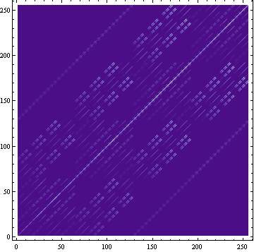

Mathematica's density plot of the Hamiltonian matrix:
Density plot on a dark purple background of a two-dimensional grid of diagonal streaks with bright spots, axes labelled 0 to 60 along the bottom and left, forming a lattice-like pattern.

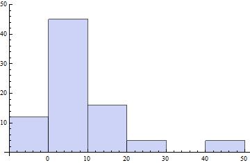

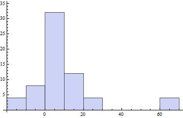

Bar histogram with light blue bars: about 4, 8, 32, 12, 4, then empty space, then 4 near x = 65. Y-axis runs 0 to 35, x-axis unlabeled.

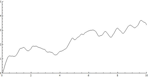

3 modes, 5 excitations (##p_1 = -1##, ##p_2 = 0##, ##p_3 = +1##):
Line graph of |C(t)|^2 against t from 0 to 10, starting at 1.0 and decreasing with small oscillations to near 0 by t = 10.

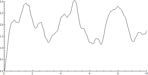

Line graph of a fluctuating curve rising from 0 at t=0 to about 3.4 at t=10, with axes labelled 0 to 10 horizontally and 0 to 5 vertically.

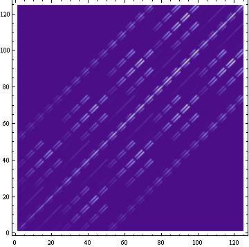

Density plot on a dark purple background of a matrix or correlation-type quantity over indices 0 to about 125 on both axes, with many diagonal streaks of bright blue and white intensity running from lower left to upper right.
Numbo = Table[{t/200, Re[vacuum.MatrixExp[I*t*H/200].NumberOp.MatrixExp[-I*t*H/200].vacuum]}, {t, 0, 2000}]
Graphics[Line[Numbo], PlotRange -> {{0, 10}, {0, 3}}, Axes -> True]
Line graph of |C(t)|^2 against t from 0 to 10, starting at 1.0, dropping sharply, then oscillating irregularly between about 0.13 and 0.73 with several peaks and troughs.
Line graph of a fluctuating curve against time from 0 to 10, rising from 0 to about 2 then oscillating between roughly 1.2 and 3.0 with irregular peaks and dips.
Density plot on a square grid, axes 0 to 80, of a matrix with a bright diagonal and sparse bright streaks forming a self-similar lattice pattern on a dark purple background.
Histogram with x-axis from about -10 to 50 and y-axis from 0 to 50; bars of heights about 12, 45, 16, 4, 0 and 4 across successive bins, with the tallest bar between 0 and 10.
4 modes, 4 excitations (##p_1 = -1##, ##p_2 = -1/3##, ##p_3 = +1/3##, ##p_4 = +1##):
Line graph of |C(t)|^2 against t from 0 to 10, y-axis from 0 to 1. Starts at 1, drops to about 0.4 near t=2.5, peaks near 0.8 at t=5, dips to about 0.4 near t=7, then rises to about 0.75 near t=9.
Line graph of a function against t from 0 to 10, starting at 0, rising to about 2.6 near t=0.6, then fluctuating between roughly 1.3 and 3.2 with several peaks and dips, ending near 1.7 at t=10.
Density plot on a square grid from 0 to 250 on both axes, dark purple background with faint diagonal streaks and small clustered bright patches forming a fine lattice pattern.
Bar histogram of a count distribution, with bars peaking near 0 at about 88 and falling off to small bars out to around 140 on the horizontal axis, with a few isolated bars at the far right.
