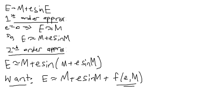

Kepler's equation: M = E - esinE, where E is to be approximated.
I'm trying to find f(e,M), a function expressed in e and M. I've tried using the trig identity sin(u + v) = sinu*cosv + cosu*sinv, but that just introduces a cosine, which I believe to be useless. Anyone with ideas?
Maybe, apply that expansion, then ...
if you are saying ∊ « 0, try approximating sinx by x, i.e., sin(∊·sinM) by ∊.sinM
and make a corresponding applicable approximation for cos(∊·sinM).
BTW, that's a great graphic!
Thanks, haha. It was done on paint.
I'm still having a little trouble applying the approximation that e is small.
Applying the trig identity, I have
E = M + esin(M + esinM) = M + e[ sinM*cos(esinM) + cosM*sin(esinM)].
Assuming that e is small, sin(esinM) goes to 0 and cos(esinM) = 1.
So, E = M + esinM, which is still the first-order approximation. Am I missing something?
Also, isn't the symbol in "∊ « 0" saying that e is much less than zero?

No. For small x, sin(x) ⋍ x (Try it on your calculator, to show I'm right.)
and cos(esinM) = 1.
Correct.
:cough: :blushing: I meant that to be ϵ « 1
If e << 1, doesn't that imply that E = M?
If you're trying to simplify an equation, that suggests you want to rid yourself of extra terms, rather than keep stringing them along.
Ah, got it, thanks.
The function is e^2*cosM*sinM. I have two questions:
1. Why not just keep all the terms even though it's a bit more complex? Wouldn't this give better accuracy?
2. I've seen the approximation that sinx is approximated as x when x is small. But x is also small. Why don't people just approximate x as zero?
To my understanding, E = M is the approximation that we are trying to improve. Sticking the zero-order approximation E = M into E = M + esinE = M + esinM improves the approximation by adding the extra term esinM. So E = M + esinM is the first-order approximation, and what I'm trying to do is find the second-order approximation where a function f(e,M) in E = M + esinM + f(e,M) is to be found.

The original Kepler equation M = E + esinE doesn't have a closed-form solution for E, like gneill just said, so approximating E is necessary.
I wrote a Matlab script for numerically approximating E via Newton-Raphson:
M = 2; e = 0.5;
E(1) = M; %initial guess
for i = 1:10
E(i+1) = E(i) - [(M-E(i)+e*sin(E(i)))/(-1+e*cos(E(i)))];
end
But I don't know how to implement the stopping criterion, where my error function could be something like err = abs(E(i+1) - E(i)), and if error < tolerance, the iterations can stop, rather than just keep iterating to 10 iterations like what the script above does. Can you guys help me with this? I've tried using the while function (while error < tolerance), but to no avail.

Accuracy is only part of the goal. Ease/speed of computation is equally desirable. Also, often it's possible to massage the simpler approximating function into something more easily comprehended than the original, leading to a clearer understanding of what the error term will be. When you can be confident the error will be contained within certain acceptable bounds, then there is really no need to actually calculate it, thus freeing you to use the fast computation of the approximating function.
Try it. First approximate sin(0.01) to 0, then try 0.01.
Let sin(0.01) ≈[/size] 0:
percentage error = ❲[/size](sin(0.01) - 0)/sin(0.01)❳[/size]* 100% = 100%[/color]
Let sin(0.01) ≈[/size] 0.01:
percentage error = ❲[/size](sin(0.01) - 0.01)/sin(0.01)❳[/size]* 100% = -1.7%[/color]
Which percentage error looks most acceptable to you? :wink:
