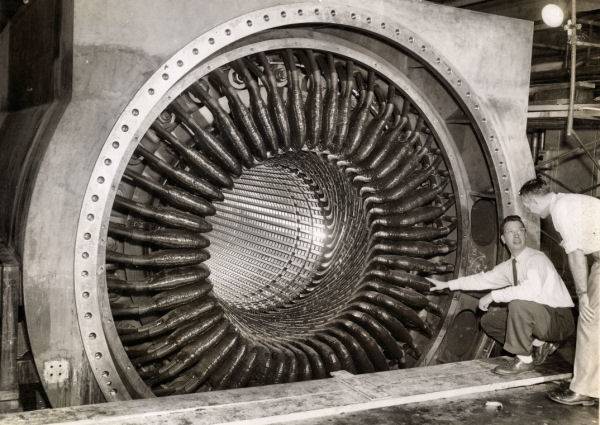

Here's a picture of an old GE machine with some people in it for perspective.
courtesy http://www.generatortech.com/index.html

Virtually, What can be done to avoid the heating of conductors?
Curious007 said:
I'm also curious about the cause(s) of Heat in conductors? Is it because of Back EMF or Just Current drawn? or something else?
Current heating the copper by I2R .
Our machine's armature current was about 20kiloamps.
20,000^2 = 400 million . Obviously winding resistance has to be in the sub-milliohm range.
Virtually = practically?
Superconducting isn't practical yet.
More copper cross section to reduce resistance, hollow vs solid conductors for more surface to volume ratio, more hydrogen pressure to give higher coolant mass flow rate.
Raising design voltage lowers current but there's tradeoffs - you need more turns or a bigger iron core and thicker insulation on the conductors...
