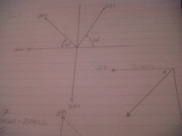

I have done the following and would just like to know if it looks correct and any advice would be appreciated
Four forces acting on a point
30N west
35N south
20N west 45deg north
25N east 60deg north
1. The sum of the vertical components and state the direction
2. The sum of the horizontal components and state the direction
3. The magnitude of the resultant
4. The direction of the resultant
5. The magnitude and direction of the equilibrant
Please note that I haven't done physics in 5 years and busy getting back into it
here is the diagram I came up with
1. 20sin60 - 25sin45 - 35N
= 17,321N - 17,678N - 35N
= -35,357N
= 35,357N South
2. 20cos60 + 25cos45 - 30N
= 10N + 17,678N - 30N
= - 2,322N
= 2,322N West
3. R² = 35,357² + 2,322²
R = √35,357 + √2,322
= √37,679
= 6,138N
4 and 5 I need help in the right direction.
any help would be appreciated.

Thank you for the feedback. I appreciate the advice!
Is the graph I drew correct?
can you maybe just explain to me what you mean with
"A 45deg triangle has sides 1-1-√2
A 60-30 triangle has sides 1-2-√3
so. sin(45)=cos(45)=1/√2
so. sin(60)= √3/2, cos(60)=1/2"
The graph you drew appears to be what was intended.
You have calculated the components of the resultant already - draw them on a similar graph. You are basically reversing the procedure you just used.
