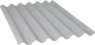

Vanadium 50, if a man carries, horizontally, at constant speed and over his head, a roof tile like the one shown bellow
this would correspond to a nicely defined plane wave, but this would not be a wave, would it?

There are two distinct instances where the maths of wave propagation apply. Some waves actually carry energy and others do not. That is a very relevant distinction but it doesn't mean that a Mexican Wave is not a 'real' Wave. One shouldn't get too wound up with classifying things too rigidly. It tends to add confusion and not resolve it.
If you happen to have a teacher for whom that is important then you are just stuck with it and you have to indulge them - but you can move on, eventually.
I would call it a wave, since you can write the wave equation to give you the height of the roof tile at a given position and time. But we're getting to the point of semantics and any minute now someone will talk about "real waves" and then later "really real waves". These seldom lead anywhere good.
