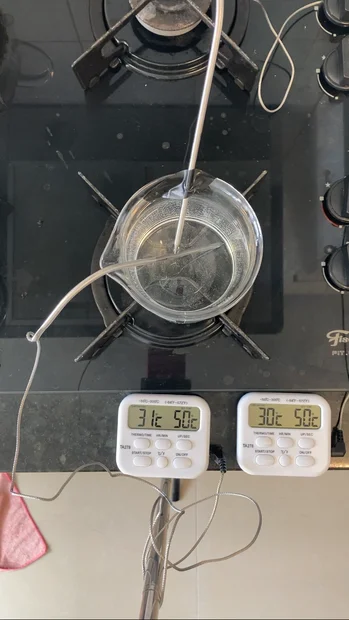

During an undergraduate physics course, are the basic axioms of thermodynamics demonstrated experimentally, or are only the theories taught?
I would like to propose a very simple experiment and ask: what is the official thermodynamic prediction for this specific setup?
And, are such basic experiments performed during physics training, or do courses move directly to more complex experiments while taking the foundational axioms for granted?
Proposed experiment:
Approximately 500 mL of tap water in a pan (glass or metallic).
Two thermometers immersed in the water: one at the bottom (touching the inner surface of the pan) and one just below the water surface.
Initial water temperature around 30 °C.
Add 5 ordinary ice cubes (which float at the surface).
Phase 1 – Ice floating on the surface (no flame, just ice melting):
What does standard thermodynamics predict regarding:
The temperature at the bottom versus at the surface?
Which region becomes colder, and which becomes hotter?
Phase 2 – After all ice has melted, turn on the flame (heating from below):
Same questions:
What is the predicted temperature behavior at the bottom versus at the surface?
During the heating process (before boiling), which region should be colder, and which should be hotter?
To be clear: I am not asking whether this exact experiment has been done. I am asking whether the most basic predictions of thermodynamics (e.g., cold water sinks, hot water rises, bottom is hottest under flame) are ever directly demonstrated in undergraduate lab courses, or if they are simply taught as axioms without empirical verification.

@Dale beat me to suggesting dye (you could also add it to the bottom of the water before heating, if you let the water settle and then use a pipette to add the dye).
I'd also add that 0° water is only 0.5% more dense than 30° water, while near-boiling water is 5% less dense than 30° water, and probably has uneven heating from the gas burner coupled with bubbles coming out of solution driving upward flow from hotspots, so much more vigorous convection. It's quite a complex and dynamic situation, so quasi-static rules of thumb like "cold fluids sink" are probably guidelines at best.
I suspect that if you do the dye version of the ice experiment you'll find that the dye does migrate slowly downwards, but sufficiently slowly that it'll mix with the warm water and equilibrate to slightly less than 30° on its way down, rather than sinking like a stone and then equilibrating.

A cheap thermal camera (~€150, clips onto a smartphone) would be a nice modern upgrade to this experiment. Instead of two point thermometers, you get a full 2D temperature map in real time.
Record a video and you literally see the cold zone forming at the top (Phase 1) and the hot zone building from the bottom (Phase 2).
Note: glass is opaque in thermal IR, so you're measuring the container wall temperature, not the water directly, but if the wall is thin enough, you should still clearly see the thermal gradient.
A metal pan would not work well here: high thermal conductivity smears out the gradient, and low emissivity gives unreliable IR readings.
Pyrex can be a good choice.
You can also use it to visualize the hot air plume above a candle, a direct demonstration of convection in air.
