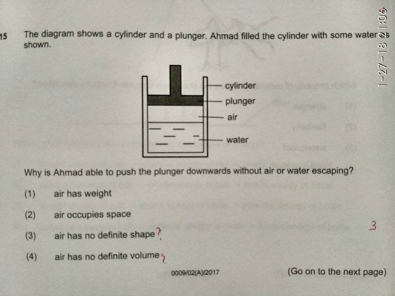

Are there two answers to this question?

1. The question is found in the file attached herein. This is a Year 3 Question. You may still use higher ability concepts to help me understand your explanation as I am a University graduate and a Science educator. 2. I understand that air is the cause why the plunger is able to move downwards. 3. The Answer is No.(4). This is due to air not having a definite volume. However, I also feel it can be due to Option (3). where air does not have a definite shape. When air does not have a definite shape, it will also cause the plunger to move downwards. Isn't this true? Please let me know if there is a mistake in this question.

Please share with me your opinion as I am not sure if my explanation is accurate.

Have you studied Boyle's Law yet? If not, look that up and I think you will see why "D" is the best of the available answers...
Alternately, look up the Ideal Gas Law -- it is a more general form for how gas volume and pressure are related.
Although technically true, I think you are reading too far into the question. Just having an indefinite shape is not sufficient to allow the plunger to be pushed down without anything escaping. For example, if the cylinder was completely filled with water then the plunger can not be pushed down. Although water has no definite shape, it is not easily compressible and has a definite volume, i.e. ##1\text{g}=1\text{mL}##. Thus, option 4 is the necessary condition.

If air had a fixed shape here, you wouldn't be able to push down the plunger, would you?
We need to read deeper in order to fully understand what's happening on the surface. This is not asking for too much for a simple question like this. Anyway it's also another option presented in the array of possible solutions found herein.

Air not having a fixed shape (ie. not being a solid) is a necesssary, but not a sufficient condition.
Air not having a definite volume is necessary and sufficient, since no fixed volume includes no fixed shape.
1 and 2 are both true, as is 3, but none are necessary and sufficient. Only 4 meets that criterion.
As NFuller mentioned, 1,2 and 3 are also true for water which does not compress. 4 discriminates between air and water and is the critical issue here.

You make an interesting point. If you approach the question by considering the consequence of each of the four predicates being false, it is clear that falsifying 1 or 2 would not result in the plunger being indepressable. The same cannot be said of 3. So purely as an exercise in logic, 3 is not ruled out.
The question would have been better if it had contrasted the situation with the case of no air being present. Since water has no definite shape either, option 3 could have been eliminated.
By the way, Ahmed did not fill the cylinder with water; he partially filled it.
Edit: as Merlin points out, falsifying 3 (i.e. saying it does have fixed shape) falsifies 4 as well, so the possible answers are "4" and "3 and 4".

This is false logic. The three cases under question are:
Solid: fixed shape and fixed volume (incompressible)
Liquid: no fixed shape and fixed volume (incompressible)
Gas: no fixed shape and no fixed volume (compressible)
The "no fixed volume" is the critical property for compressibility. Logically, having "no fixed shape" is necessary but not sufficient. If the question was to be logically phrased you could replace "Why ..." by "What is the necessary and sufficient condition ...".
askbbj said:
Imagine for once, if air had a fixed shape here, you wouldn't be able to push down the plunger, would you?
Sure you would. The air in the container could then shrink away from the walls and allow the piston to be depressed. Having no fixed shape is neither a necessary nor a sufficient condition for an object or substance to allow the plunger to be depressed.
There are real world objects with a fixed shape but not a fixed volume. Air happens not to be one of them.

The point is that whether air has a fixed shape or not has no bearing whatsoever on the question of whether the plunger can be plunged.
A claim had circulated in this thread that having no fixed shape was a necessary condition to having the plunger plunge. It is not.
1. Something with no fixed shape can resist the plunge (e.g. water)
2. Something with fixed shape can resist the plunge (e.g. steel)
3. Something with no fixed shape can fail to resist the plunge (e.g. air)
4. Something with fixed shape can fail to resist the plunge. (e.g. a hoberman sphere)

We are asked about which attributes of air allow it to fail to resist the plunger. A lack of fixed shape is not such an attribute because an object with a fixed shape can still fail to resist the plunger. QED.
Edit: Let us take the other side of the argument for a moment. The challenge then is to present an object or substance which has a fixed volume but which nonetheless fails to resist the plunger.
