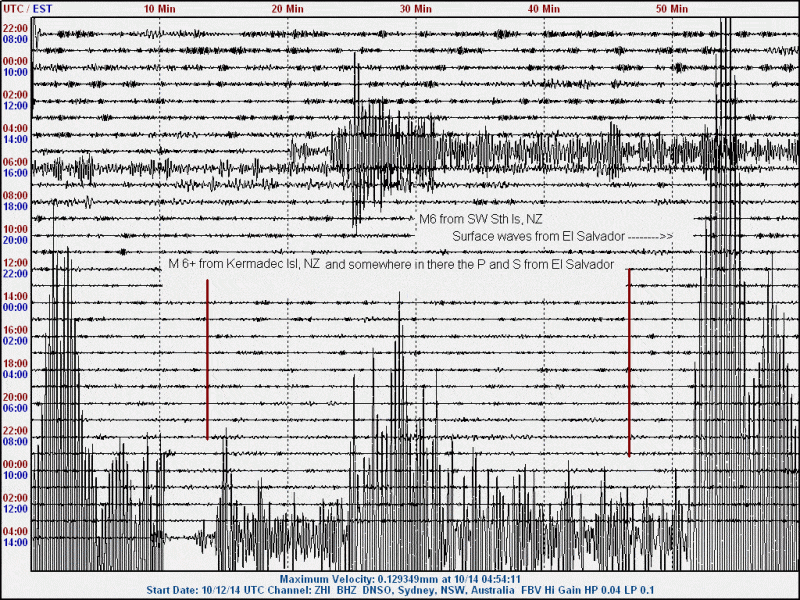

hi guys
a double event, 2 x M 7.4 events offshore El Salvador coming in on seismo NOW
these are only 1 minute apart
The magnitude is a preliminary one and could change
UPDATE: they have removed one of the events
cheers
Dave
well this turned into a tricky situation
After the M 7.3 ( downgraded from 7.4), Central America there was a M 6.1 (USGS), M6.5(GNS Geological and Nuclear Sciences, NZ)
which because it was closer to me arrived first. And buried in its signal is the P and S arrivals of the M7.3
141014  UT  M 6.5 Kermadecs and 7.4 offshr El Salvador zhi annotated - Copy.GIF
