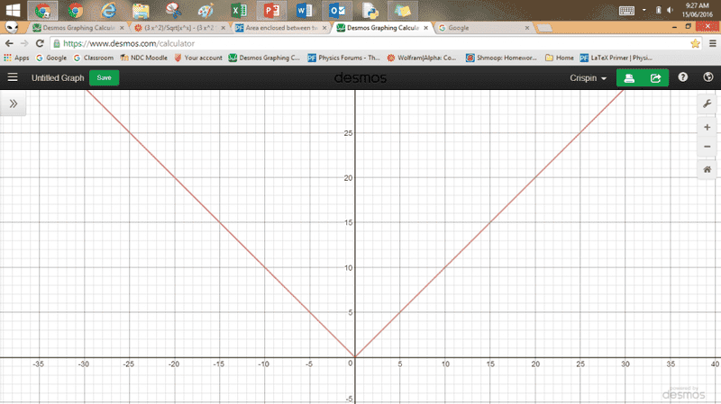

f(x) = √(x+2), g(x) = d/dx (f(x))^(f(x)). Find the total area enclosed between g(x) and √(x^2) correct to 3 decimal places.
Knowledge of differentiation and integration - specifically areas between curves.
I've attempted to solve g(x) = √(x^2) on my calculator but I keep receiving an error message. I've defined f(x) as equaling √(x+2), and I don't see where I could be going wrong. I know after I've found the points of intersection, all I need to do is set up definite integrals over the relevant domains with the graph on bottom over said domains being subtracted from the graph on top.

Ah thank you for the advice. The square root of x squared simplifies to x, but the rule ##\sqrt{x^2}## sketches a distinctive graph due to the fact you must square x before square rooting it - this means y cannot be a negative number. Here's a picture to show you.
No, that's not why. ##\sqrt{x^2} = |x|##, the absolute value of x. If what you said was true -- that ##\sqrt{x^2}## simplifies to x, the graph would be a straight line through the origin, with a slope of 1.

You have just drawn a graph of the absolute-value function |x|.
