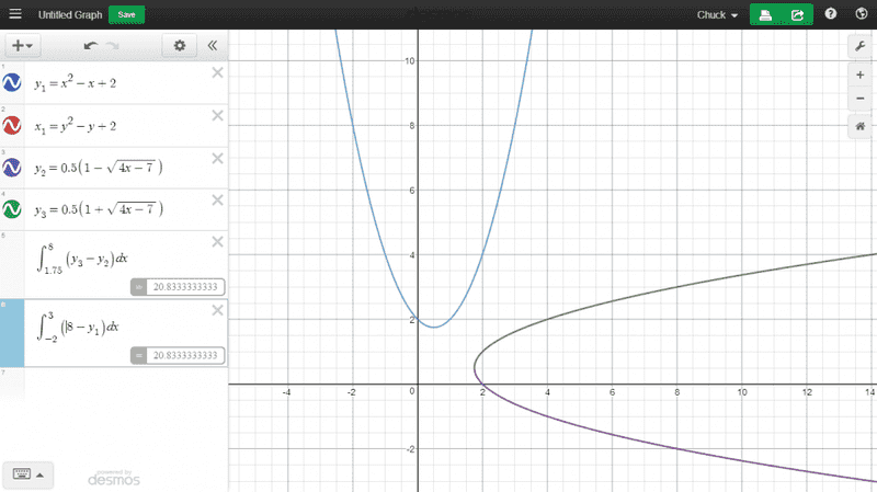

I'm honestly at a complete loss as to what you're talking about. Swapping x and y in the formula has the exact same effect as swapping the x and y axes. Look at what I mean:
Say you're given the equation x = y^2-y+2 and are asked to determine the total area enclosed between x=1.75 and x=8. Using your method, you have to solve for y and then set up an integral in which you subtract the bottom part of the equation from the top part as shown in the picture above. However, if you instead simply swap the x and y variables around in the equation and set up an integral subtracting x^2-x+2 from 8, then you get the exact same area as the first method. This method is much more time efficient as you don't need to rearrange the equation and it's easier to do without the use of a calculator.
Sure, we get this. It's not that these are two operations with the same effect -- they are in fact the same operation. But swapping x and y is not the same as finding the inverse of a function.
All you're doing is exploiting the symmetry of the parabola. The parabola that opens to the right is symmetric about the x-axis. The parabola that opens up is symmetric about the y-axis.

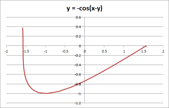

When I have to do this kind of thing I always try to draw a picture. First a few points (x=0 ##\Rightarrow## y= ... and y = 0 ##\Rightarrow## x = ...)
Then I grab excel to give me a few more points (cumbersome: the solver only let's me do one cell at a time). So I grab an equation solver and get something like:
(the y = cos(x-y) is the same rotated 180 degrees around the origin).
I don't loose a portion of the graph. Is it because I don't use the arccos function ?

Saracen Rue said:
... which gave me the answer of 4 square units. Does this sound like it could be right to you?
That looks like the correct result for the area enclosed by the given relation for -π/2 ≤ x ≤ π/2 .
I don't know why it says between the graph and x-axis. The graph of the relation itself encloses a region.
