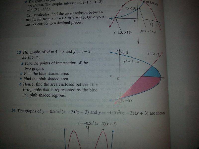

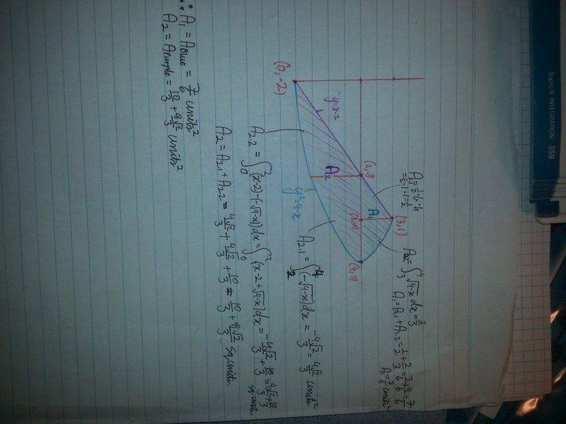

The answer in the back of the book says that part c should be 10/3, but that would mean that (8sqrt (2))/3 would need to cancel out in both area 2.1 and area 2.2, whichdoesn't work because areas are always positive.
Textbook page showing exercise 13: the parabola y^2 = 4 - x and the line y = x - 2 meet at (0, 2) and (0, -2), with the blue shaded area above the x-axis and the pink shaded area below it.
Handwritten working on lined paper, rotated sideways: a shaded region bounded by the parabola y^2 = 4 - x and the line y = x - 2, with points (0,-2), (3,1), (4,0) and (2,2) marked and areas A1 and A2 split by a horizontal line, with integral expressions for each part.
Why didn't you calculate the area under the parabola and only subtract the triangle? It seems you used more areas than necessary. But I'm not good at reading on the side.
Ah yes that is a much better idea thank you. But still, my method should still be getting the same answer but it's not. Could you please explain to me where I'm going wrong?
View attachment 101868 View attachment 101869
Areas may always be positive, but definite integrals are not required to be positive. To calculate an area using a definite integral sometimes requires some interpretation of what the definite integral means in that case.

Going off fresh_42's comment, you can also evaluate the definite integral to calculate the area under a curve using dy instead of dx as the variable of integration.

To be honest: I didn't like the root expressions. First thing I did was to exchange x and y.
In other words, using horizontal strips instead of vertical strips.

You don't need to know anything about conics to switch the variable of integration. Often times, switching is done as a matter of convenience to simplify the integral.
I think my main problem is that I still don't know how to calculate the area between two curves properly.
Say I was just given y=x-2 and y=-sqrt(4-x) and had to find the area enclosed between them between x=0 and x=2
Isn't the correct way of doing this to just set up an integral over the given domain and subtract the function on the bottom from the function in top? So integral(2, 0, (x-2-(-sqrt(4-x)))dx

... or simply exchange x and y and integrate as you are used to, which is the same.
