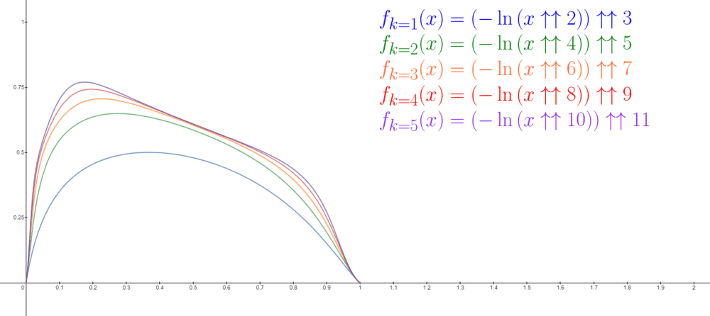

I've been playing around with Up-Arrow notation quite a lot lately and have come up with the following "thought experiment" so to speak. Consider the following function: $$f(x)=(−ln(x↑↑(2k)))↑↑(2k+1)$$ $$\text{Where }k∈\mathbb{Z} ^+$$
In the image below we can see some examples of what this function looks like for the first ##5## values of ##k##:

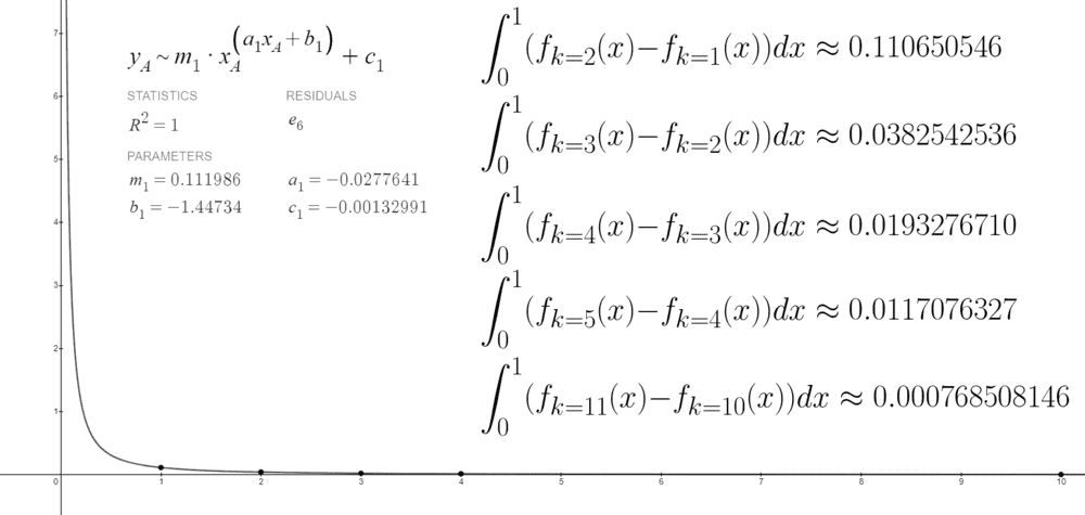

It can be visually seen from the graphs that while the area under each graph does become larger for increasing values of ##k##, the rate at which the area is increases decrease. However, I went ahead and took the liberty of doing the calculations anyway. I found the difference in area between ## f_{k=2}(x)## and ## f_{k=1}(x)##, and then between ## f_{k=3}(x)## and ## f_{k=2}(x)##, and so on. I then took these values and plotted them as such:
(Note: The graphs of ##f_{k=10}(x)##and ##f_{k=11}(x)## weren't included previously, they are only being used here now to help with the accuracy of the curve fitting)
Each point was plotted in the following manor: ##(1, \int_0^1(f_{k=2}(x)-f_{k=1}(x))dx), (2, \int_0^1(f_{k=3}(x)-f_{k=2}(x))dx), \text{etc}.##
The points were found to fit the general relationship of ##y_A \approx m_1 x_A^{a_1x_A+b_1}+c_1## extremely well, have an ##R^2## value very close to ##1##. This leads me to believe that this relationship appropriately represents the difference in area between different values of ##k## in ##f(x)##. Therefore, because this regression curve approaches ##0## as ##x## approaches ##\infty##, the area enclosed by the graph of ##f(x)=(−ln⁡(x↑↑(2k)))↑↑(2k+1)## must approach a constant value as ##k \to \infty##.

The differences going to zero is not sufficient. ##\displaystyle \sum \frac 1 n## has the differences between partial sums going to zero, too, but clearly the sum diverges.
I think you can prove that 1 > fk > fk-1 for all x between 0 and 1, that is sufficient for convergence.

Thank you for letting me know. I was never taught about convergent/divergent series in school, so I'm still not very confident with this area of maths. I would very much appreciate if you could help with how to go about proving ##1## ##>## ##f_k## ##>## ##f_{k-1}## for all ##x## between ##0## and ##1##.
