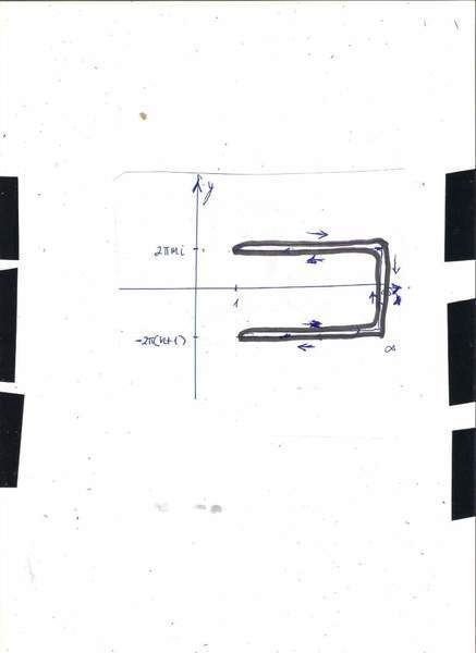

. I want to prove that there is one solution for e^z-z in every shifted copy of the fundamental strip by applying the argument principle to the boundary of a rectangle −M≤Rez≤M , 2kπi≤Imz≤2(k+1)πi for large M and integer k . I need help in using the argument principle here.
Argument principle.
I tried to compute the integral of the logarithmic derivative along the boundary of the square,but I'm stuck with it.

if we consider ,instead ,the rectangle −M≤Rez≤M ,- 2mπi≤Imz≤2nπi for large M and integers m and n,then the image would be a new rectangle around the origin,transversed possibly several times.Is it true that it is transversed m+n times?

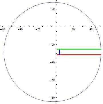

Afraid that's not exactly correct: The image of the lower and upper legs of the contour remains in the fourth quadrant. The plot below is the image of [itex]f(z)=e^z-z[/itex] for m=4 and k=4. Red and green contours are the images of the upper and lower legs of the rectangle. m has to be large enough for the image to encircle the origin. If m=2 and k=4, the image remains in the lower half-plane. So I assume that is why the problem stipulates for large (enough) m.
Sorry I posted before adequately studying the problem.

The image is as shown in the attached,so the change in argument is zero,am i right?
