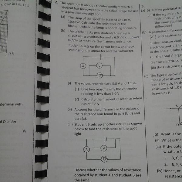

First image-question

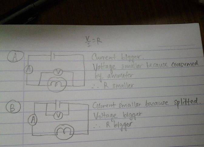

Second image-my interpretation/working.

V=IR
In the second image
I really don't understand what does the answer mean.
I assumed the first half of the answer is referring to circuit A, but still it doesn't seem to make sense.
Someone please explain to me why my working is wrong, thanks.

I don't follow the book answer either. Is there any other info in part (a) not shown in the image? eg anything that allows us to assume the voltmeter is ideal or at least can be assumed to be ideal.
Do you have two answers for Q (b)(I)(1) ?
Student A will calculate a value of about 3.87 Ohms if he assumes both meters are ideal. I don't think there is enough info for him to calculate any other answer unless it's in part (a).
Please see image attached.
Yes. 1. Ammeter has finite resistance. 2. Internal resistance of the battery.
