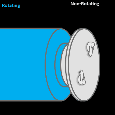

OK, I've read this thread and a few others, and what I can't see is the 'docking procedure' for such a space station.
I'm working on the second "Guardian" novel and am considering a tubular space station, 12km in length and 6km in diameter, which for a simulated 1G on the interior surface means I only need 0.386 RPM so that's a reasonable figure.
But, how do you enter the thing? That rate of spin imparts almost 900 km/h tangential speed, which is not a lot in the scheme of things, but to maintain in a circle as you approach? It seems unfeasible.
To get around this, most sci-fi stories have zero gee airlocks at the ends. But, from my understanding, the centripetal force (aka 'artificial gravity') only acts upon objects in contact with the interior surface. It's not like a planet, where gravity builds up as you get closer.
So, you enter via the air lock at the end, in zero gee. And you're in zero gee until you make contact with the rotating interior wall (floor?). Which suddenly imparts 1G load upon you...or almost 900 km/h tangential speed?
I can fluff this for the sake of the story, it's sci-fi after all, but how exactly do you safely enter one of these things?

DaveC426913 said:
Problem with that system is that it is not scaleable.
If you have a very large spinning habitat you can also build a counter-rotating space port at the end. No need to mess around with runways or trying to dock on the spinning outer/inner surface. Just have a disk-shaped space port jutting from the end like a mushroom cap on a coke can. Space craft dock, people and items travel through the port in zero-g. They then take an elevator or a curved track down to the inner surface. See this quick mock up for more detail:
Diagram of a spinning cylindrical habitat seen end-on, with a small counter-rotating circle at the top, curved blue arrows showing opposite rotation, a black dot marking the docking point, and a downward blue arrow down a central shaft.
  • Diagram of a spinning cylindrical habitat seen end-on, with a small counter-rotating circle at the top, curved blue arrows showing opposite rotation, a black dot marking the docking point, and a downward blue arrow down a central shaft.
Yep. That works too.
And has the decided advantages of:
  1. leaving all the scary approach, maneuvering and touch-down procedures on the outside of the station.
  2. All differing-velocity-interface hijinks are in a single, restricted well-controlled and low-energy location.
  3. Any small problems, and the shuttle can just back away in any convenient direction.
  4. Any big problems, and the habitat is well-protected from damage behind the landing cap.
(Though I can't make heads or tails of your diagram. Here's my take)
Diagram of a rotating cylinder in blue on the left, labelled Rotating, meeting a grey disc on the right labelled Non-Rotating, with two small cartoon hand symbols on the disc.
  • Diagram of a rotating cylinder in blue on the left, labelled Rotating, meeting a grey disc on the right labelled Non-Rotating, with two small cartoon hand symbols on the disc.

Thanks for all the pointers and suggestions. I'd totally forgotten about the sequence in "2001", that'll help cement the concept for me. Plus, reading your posts, I only just realized that if there is a ladder or elevator attached to the 'floor', then if you start using it your frame of reference will include the centripetal force, however weak at the center of axis, which will increase as you 'descend'. That was my main mental stumbling block with this concept, so having it sorted is much appreciated :smile:
