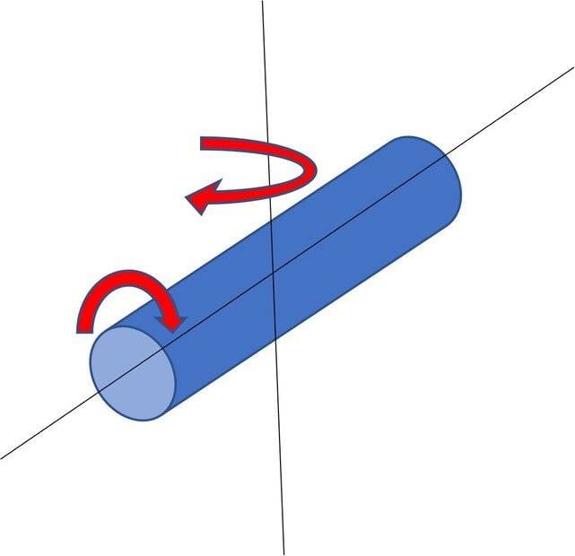

I get the mathematics, but I still don't "see it"
The rotation for the diagram I shown has a magnitude of the vector in the shaded plane, and is rotating about an axis through the origin in the direction of the vector. My brain is refusing to cooperate in understanding this.
erobz said:
I'm not understanding something, is this following scenario not considered rotation about two axis at once?
I'm with you and Dave on this one. It sounds like everyone else is saying the two circular rotations add up to a new circular rotation for any given point on the object. But it's shown in the video you posted (#10) that the points are not following a simple circular paths.

Let's see, how mathematically the angular velocity comes about. To this end think of a rigid rod with one end fixed and free to rotate around this point. Make ##\vec{n}(t)## the vector from the fixed end to the other end. Then it's clear that
$$\vec{n}(t) = \hat{D}(t) \vec{n}_0,$$
where ##\vec{n}_0=\vec{n}(0)## is the vector at time ##T=0##, and ##\hat{D}(t)## is a rotation. In the following I consider ##\vec{n}## as the column vector of its components wrt. a Cartesian basis. Then ##\hat{D}(t)## is a orthogonal matrix, fulfilling ##\hat{D}^{\mathrm{T}} \hat{D}=\hat{D} \hat{D}^{\mathrm{T}}=\hat{1}## with ##\mathrm{det} \hat{D}=1##.
Now let's take the time derivative:
$$\dot{\vec{n}}(t)=\dot{\hat{D}}(t) \vec{n}_0 = \dot{\hat{D}}(t) \hat{D}^{\text{T}}(t) \vec{n}(t). \qquad (*)$$
Now from the orthogonality of ##\hat{D}## we have
$$\dot{\hat{D}} \hat{D}^{\text{T}} = -\hat{D} \dot{\hat{D}}^T = - \left ( \dot{\hat{D}} \hat{D}^{\text{T}} \right)^{\text{T}},$$
i.e., ##\hat{\Omega}=\dot{\hat{D}}(t) \hat{D}^{\text{T}}(t)## is an antisymmetric matrix, and we thus can write
$$\Omega_{jk}=\epsilon_{jlk} \omega_l,$$
and thus from (*)
$$\dot{n}_j=\Omega_{jk} n_k = \epsilon_{jlk} \omega_l n_k = (\vec{\omega} \times \vec{n})_j,$$
or
$$\dot{\vec{n}}=\vec{\omega} \times \vec{n}.$$
One calls ##\vec{\omega}## the angular velocity. The change of the vector ##n## during a small time ##\mathrm{d} t## is
$$\mathrm{d} \vec{n} = \mathrm{d} t \vec{\omega} \times \vec{n}.$$
From the geometrical meaning of the dot product that means that the infinitesimal rotation is around an axis given by the direction ##\vec{\omega}/|\vec{\omega}|##, implying the direction of rotation to be according to the right-hand rule, and the infinitesimal rotation angle is ##|\vec{\omega}| \mathrm{d} t##.
Of course you can decompose ##\vec{\omega}## in terms of an arbitrary (Cartesian) basis, and the infinitesimal rotation can be seen as composed of several infinitesimal rotations around the corresponding axes, but still it's just a rotation around one given axis.
