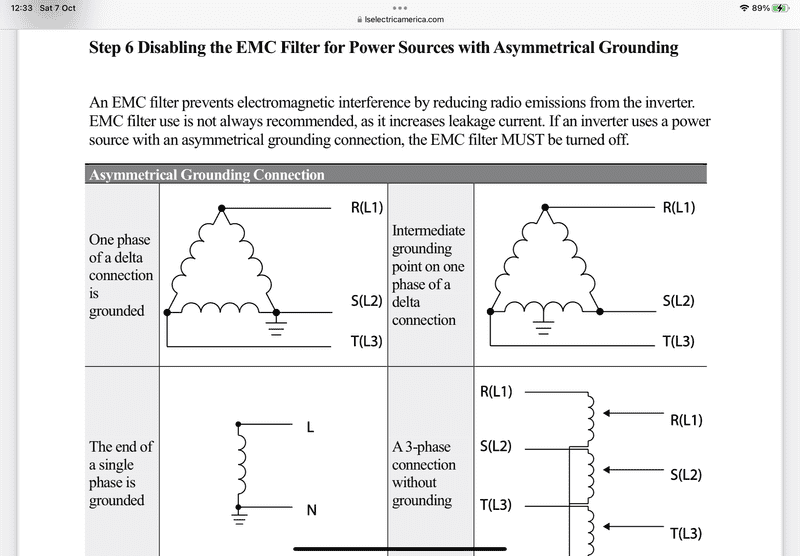

3 phase motor being run on a 1 phase supply, via a VFD/inverter drive. The VFD manufacturer mentions ‘asymmetrical grounding’ in the manual. What is it?
A single phase, 240V AC supply is used to power the 3 phase motor on my milling machine. A VFD is used to generate the 3 phases required, along with the other benefits such as overload/overvoltage protection, soft start, braking, speed control, reverse, etc.
The VFD has an inbuilt EMC filter. The manufacturer recommends disconnecting this if used on supplies with ‘asymmetrical grounding’. Now, although I’m familiar with installing VFDs/motors, I’m not familiar with this term. Given the use of the term ’grounding’ rather than ‘earthing‘ as we in the UK call it, I wondered if anyone on this mainly USA-based forum could shed any light.
Here is my supply:
And here is the relevant page from the VFD manual:
The bottom left image appears to show what I have, which is a standard setup over here. I’ve never heard it called asymmetrical grounding, however. To me, it looks like I should disconnect the EMC filter.

They are referring to any setup where the voltage magnitude from each input to ground isn't equal. So, the "symmetrical" grounding of single phase would be like a 240V winding with the center tap grounded. This 240/120V 1Φ is the common LV distribution in the USA for residential areas. In Europe the distribution is more often 380/220V 3Φ (wye) with the neutral grounded. This creates symmetric grounding for the 3Φ source, but asymmetric if you only use one leg to make 220V 1Φ.

What confuses me slightly, if you look at the top right picture, is that by using phases S and T, you would have symmetrical grounding.

Yes. You get 1 leg of higher quality 1Φ that way, at the expense of weird grounding for the other two 1Φ legs, and a pretty insignificant improvement in the 3Φ grounding. It's more expensive to do, transformer winding-wise. Of course nothing is better for grounding than wye with a grounded neutral, but that is also more expensive for the power company. The cheapest version is Δ with one node grounded.

In your case of feeding a single phase to your VFD, then yes, that is the case. But if you used all three legs then you would not have a symmetrical ground.
The reason they warn about an asymmetrical ground is because the lowest voltage from all hot conductors to ground will be in the case of symmetrical grounding. Move in any direction and one of the legs voltage to ground will increase while other legs decrease. Depending on supply voltage, this could trigger MOV type over voltage devices depending on the devices they chose to use.
Of course this is all about EMI filter design. If you search for filters you will often see this distinction between symmetrical and asymmetrical grounds. It's really all about the capacitors to ground inside. In addition to @Averagesupernova's comments. Some issues are size and voltage rating of those capacitors, and the introduction of ground currents. In a balanced system you can have more capacitor current because they mostly cancel each other. So you will often see significantly different designs for these two cases.
They are saving size and cost for the same performance by requiring balance. It does make me wonder about their EMC approvals, why have a filter in one case and none in the other? Either you need it or you don't. The EMC requirements have been mostly globally harmonized for a long time now.

Well, yes, I was reading the bit about disabling the filter, expecting this to be needed only in ‘weird’ earthing setups like the IT system of Norway, but was surprised to find my, very common, system tucked away in the diagrams. I wondered why the unit would be designed this way, and as you say, cost might be the answer.
I’ve just noticed in my screenshot above, that the manufacturer is listed as ‘LSAmerica’ (I thought it was Korean), so perhaps my model was designed with the dual phase system in mind.
