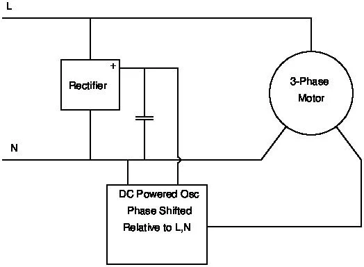

To be clear, I’m not asking about variable frequency drives (VFDs, inverter drives). These rectify the 1-phase onto a DC bus, then use PWM to generate three phases 120deg apart. They can vary the output frequency.
DPCs, also (I think) called digital phase shifters, apparently feed the 1-phase straight through, and generate a third leg from a DC bus electronically. Their output frequency is fixed to whatever the input is.
Circuit schematic of a digital phase converter: L and N mains lines feed a rectifier and DC capacitor, which powers a box labelled DC Powered Osc, Phase Shifted Relative to L,N, whose output feeds a 3-Phase Motor.
I can’t see how they approximate real 3-phase - the mains input peaks would be 180deg apart, so interspersing an artificial leg would give a double waveform, with two +ve peaks then two -ve peaks, all 90deg apart. Perhaps this is ‘good enough’ for running the motor?

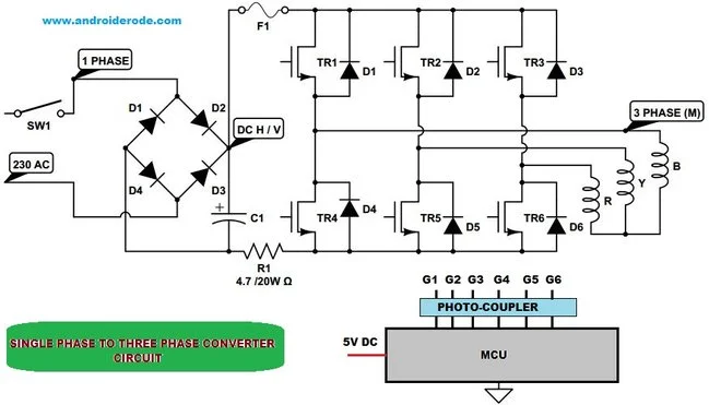

I just did a quick Google image search on "220v single phase to 3 phase digital converter electrical schematic". Here is the URL one of the first results.
Circuit schematic of a single phase to three phase converter: 230 AC input through switch SW1 and a diode bridge to DC H/V, filtered by C1 and R1, feeding six switching transistors TR1 to TR6 with diodes, driven by an MCU via a photo-coupler on gates G1 to G6, producing three phase outputs R, Y and B.
Based on this and some other search results, most of them (perhaps all) follow the same basic steps: Convert to DC then modulate each of the three phases digitally.

Alternately, by using a phase shift capacitor to drive the third phase, the circulating field that sets the direction of the motor is decided. The motor is not receiving true 3PH and must be downgraded.
I have examine more schematics. Apparently, power conversion dealers feel comfortable calling anything short of coupled motors as "digital".
When I compare the diagram presented in the OP with numerous converter electrical schematics, it seems very likely that the "motor" in the OP's diagram presented is an "Idle Motor" and is part of the power conversion circuit. When I first looked at it, I interpreted it as an example load.
If so, then that powered oscillator is only providing enough off-cycle phase to keep the motor spinning in the right direction. The motor itself is providing power to the third phase most of the time.
Even though the OP's diagram does not show it, I think that (your "alternately") is basically what the it is doing.
The OP's diagram does not show any direct connection between "L" and his "DC Powered Oscillator". But without such a connection, that "oscillator" would have of being in (or staying in) a useful phase.
I would guess that that "oscillator" is actually a power amplifier with its input coupled through capacitors to L and N.
Actually, there is a way that the OP's circuit could work without a direct connect to L. The line from the oscillator to the motor could provide the oscillator with a reference to the phase on "L". It would be a tricky analogue circuit, but I think it could be made to work.
But, I don't think that's it. Such a circuit would become very confused by the wrong kind of load.

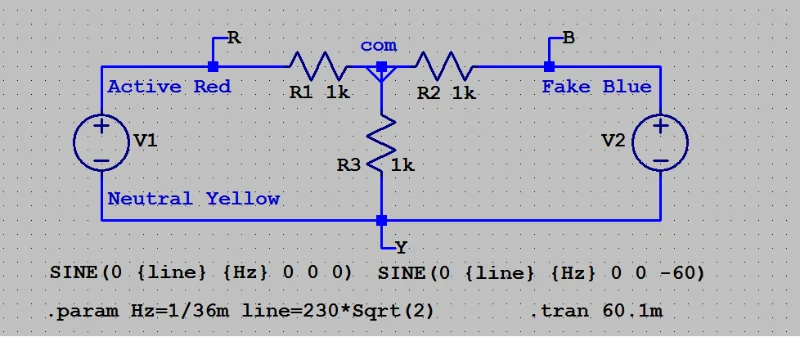

This is one way to convert a single phase, active with neutral, into three-phase lines with 120° separation.
LTspice schematic of a three-phase simulation: source V1 labelled Active Red feeds node R through resistor R1, node com is the star centre with resistor R3 to Y, and source V2 labelled Fake Blue feeds node B through resistor R2.
The neutral becomes the Yellow line, Y, while active, (source V1), becomes the Red line, R. The DPC then only needs to generate (source V2), the fake Blue line, B, such that it has a 120° phase separation from both R and Y.
Since the R and B lines are both referenced to Y, they are being measured in different directions around the phasor diagram, so one is reversed in time, or inverted = 180°. For that reason, we need a phase shift of 180° – 120° = 60°, not the obvious 120° shift when faking the B line.
The R, B and Y lines are referenced to the common at the centre of the motor phasor diagram, not to the neutral input. The motor is represented by the three resistors in star connection. The actual phase voltages across the motor, in delta connection, will be R-B, B-Y, and Y-R.

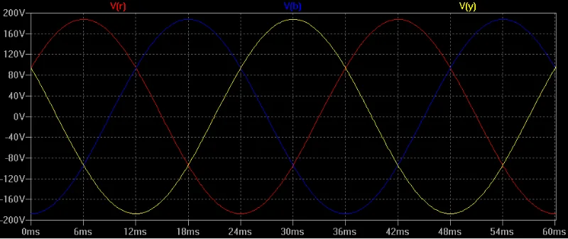

Simulation plot of three sinusoidal voltages versus time, 0 to 60 ms, with V(r) in red, V(b) in blue and V(y) in yellow, each peaking near 180 V and offset in phase; the vertical axis runs from -200V to 200V.
For this simulation, the line frequency has been adjusted so 1ms = 10°. Phase angle can therefore be read from the time axis. The line voltage input is assumed to be 230 Vrms, so the peak amplitude relative to neutral is almost 400 V. Spice assumes peak voltage is specified, hence the root two in the amplitude of voltage sources V1 and V2.

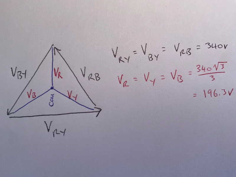

That’s very clever. I’m trying to understand the circuit in terms of two sinusoidal voltage sources, VRY and VBY. Both are of magnitude 340V, the mains peak in a 240V country:
##V_{RY} = 340V <0°##
##V_{BY} = 340V <-120°## ie, reflected from 60°
Should the final result should look something like this, with the resultant voltage ##V_{RB} = 340V <120°##, and the common/star point ‘com’ in the centre of a delta?:
Handwritten phasor diagram of a three-phase star and delta: a triangle with corners labelled VBY, VRB and VRY, with a centre point labelled com joined to each corner by VR, VY and VB. Beside it, VRY = VBY = VRB = 340V and VR = VY = VB = 340√3/3 = 196.3V.
I’m not entirely convinced I have the ##V_R, V_Y, V_B## right.

Your diagram is correct, but the voltages are confusing because you do not indicate if a voltage is Vrms or Vpk, so it is hard to reconcile with the plots of voltage.
When I started to model the converter, I decided the line voltage was 230Vrms, so I used that as the 1PH input, that was correct.
However, the single phase line voltage is used immediately to make the 3PH phase voltage, R-Y, which must therefore be 230Vrms.
The effective 3PH line voltages are therefore 230 / √3 = 132.8Vrms, which will then be 132.8 * √2 = 187.8Vpk, and that is what the model shows.
That explains why the 3PH line voltages do NOT peak at 230 * √2 = 325Vpk.

They’re all peak voltages, which seems to work:
Using geometry, the distance D of each vertex of the delta to its centre, ie ##V_R, V_Y, V_B## is calculated from the side length A, 340V: ##D=\frac {\sqrt3 A}{3}=196.3V## as shown.
Also, 340V peak across two motor phases gives a peak phase voltage ##V_{pk, phase}=\frac {340}{\sqrt3}=196.3V##

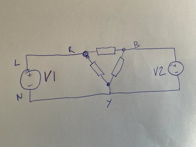

So, the typical application for a DPC would be a motor configured in delta. Would it look something like this?:
Hand-drawn circuit schematic: single-phase source V1 with L and N terminals feeds nodes R and Y, while a delta of three resistors connects R, B and Y to source V2.
Yes.
