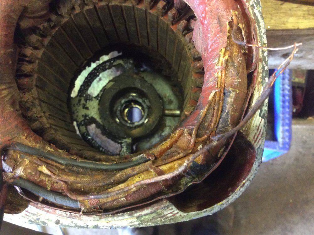

I have a 1960s mortiser powered by a three phase motor. I can get a three phase supply to it, but is there another way?
The motor from this fine, old and very heavy machine is designed to take UK 3ph, 415V. There are only three connections inside, and the nameplate says it’s wired in star. I have stripped it down and cannot locate the star point.
I was hoping to rewire it to delta, and run it with a 1ph/240V to 3ph/240V inverter drive. This doesn’t seem possible, so I think I have three options:
1: Send the motor to a rewind shop to bring out the star point. Is this feasible?
2: Find an inverter drive that converts 1ph/240V to 3ph/415V. I can’t seem to find one; do they exist?
3: Run a 3ph supply to the machine - the simplest, but it may be costly.
I imagine 3 is the best, but even so, I’d be interested in hearing about the other two options.

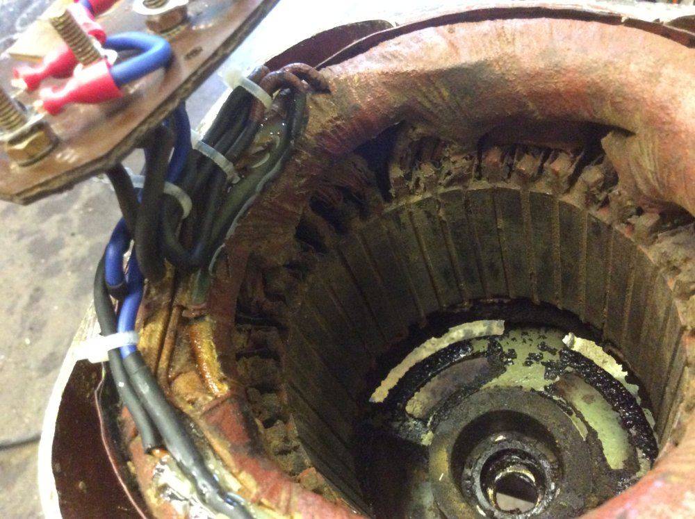

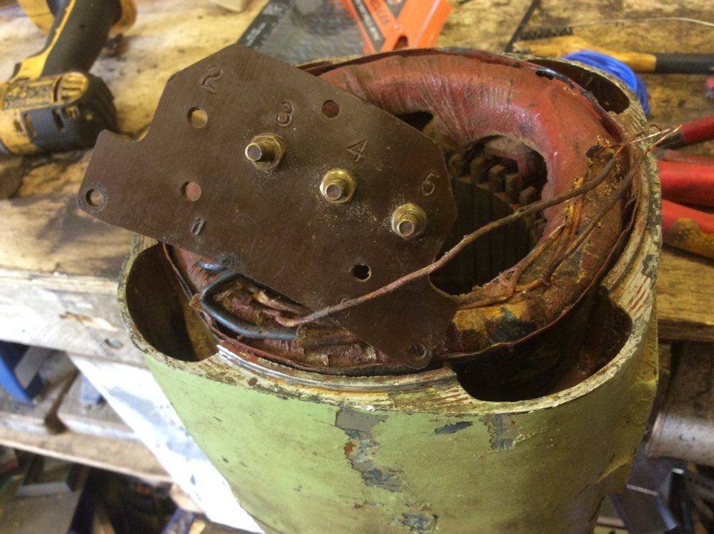

I’ve made some progress...
I re-opened the motor, and had a gentle dig in the top of the windings. I found three wires joined together, which when separated showed continuity with only one of each existing terminal:

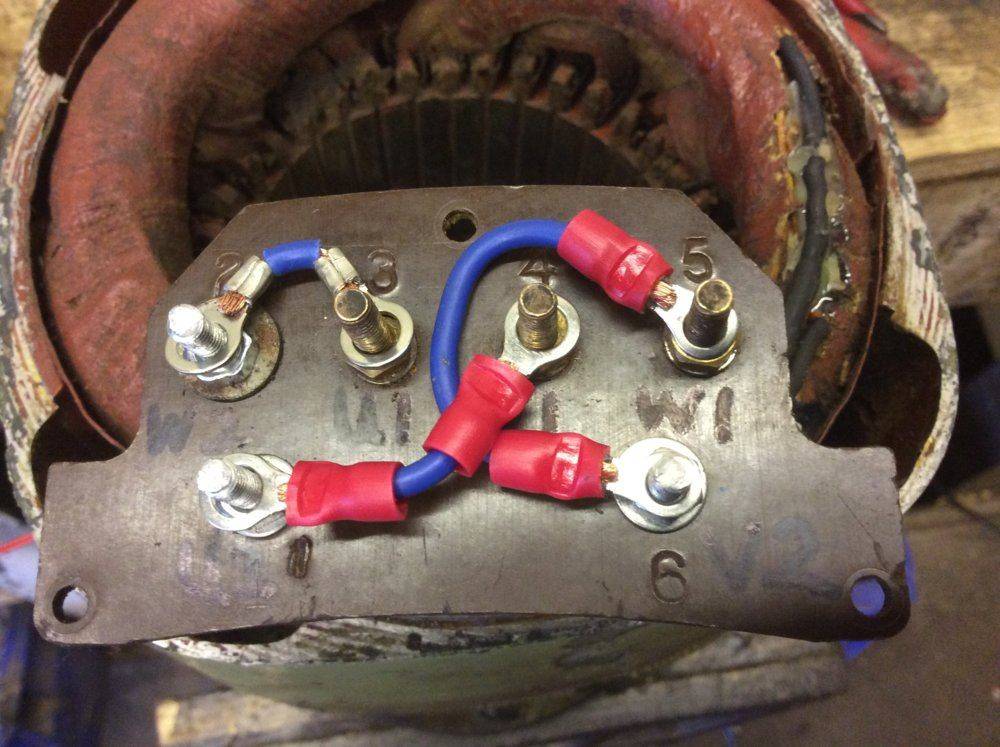

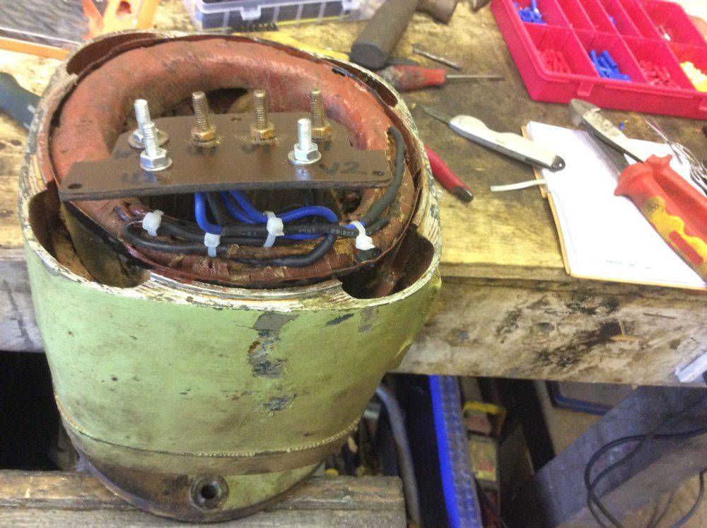

I extended each wire with flex, the joint being covered with doubled heat-shrink tubing, and brought out the connections to the paxolin panel:
Epoxy to repair the work:
Now the motor can be configured in delta:
I verified the winding designations, then tested for insulation resistance between phases and from each phase to Earth at 1000V. All readings were over 100 MOhm.
So hopefully I can now use it with a standard VFD putting out 3ph/240V.

Yes, sorry, I forgot to state the power, which is only 500W or 3/4hp. The motor is a custom fit to the machine (no belts/pulleys) so replacing with a 1ph might be tricky.

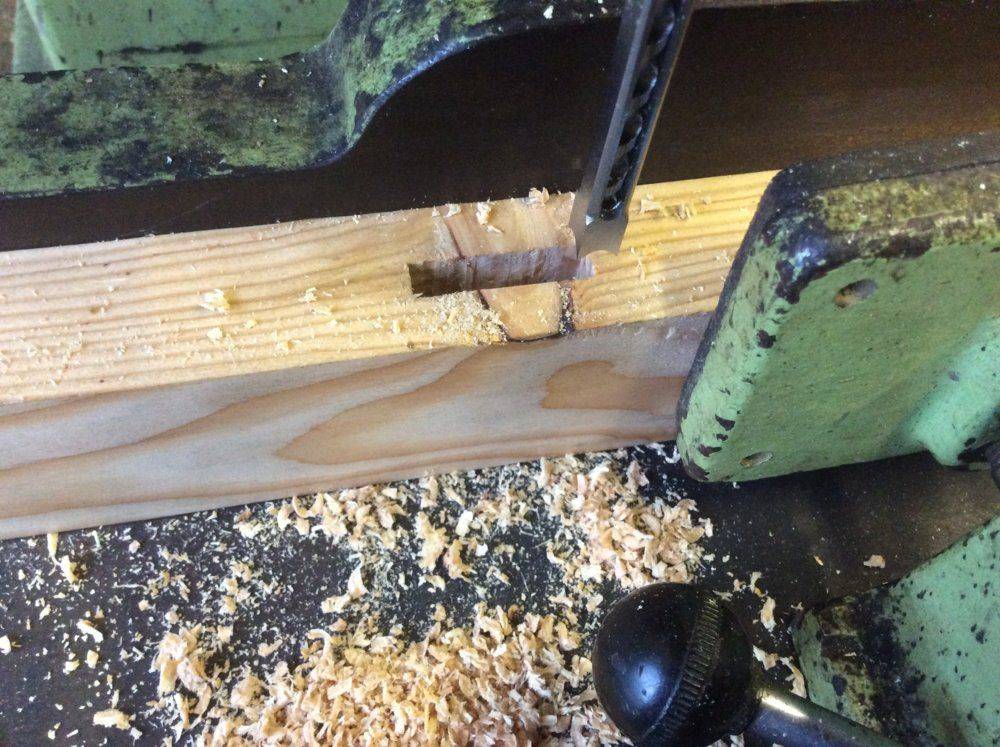

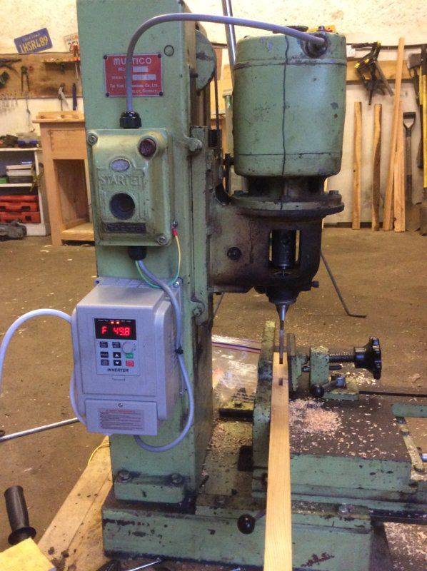

It is now sorted and running with a 2.2kW inverter drive. I’ll show a pic of the final setup in case it helps someone else.
Pics as promised:
Power comes in direct to the inverter, and the old DOL starter is bypassed and just used as a junction box.
The machine makes short work of mortices, even through knots!

It is not usually a problem with three phase input to a VFD, but when converting single to three phase you may find that there is insufficient internal reservoir capacitance to hold charge through the low voltage parts of the one input cycle.
Some VFDs have terminals that allow additional external reservoir capacitance. That may allow greater output power.
Look at the terminal assignment to identify if external capacitance is supported. Read the manual to identify the capacitance selection and the limits.
I see what you mean - where the single phase crosses zero the three phase does not. With this sort of thing in mind, as well as longevity, I bought an over-rated, 2.2kW drive to power the 0.5kW motor. It seems to work nicely, and the speed ramp-up is a nice feature.
