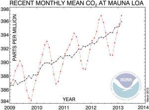

Every which growing season? The graph "Recent Monthly Mean CO2 At Mauna Loa" clearly shows an annual cycle.
I would have expected the CO2 use to be more or less constant with both hemispheres alternating production.
CO2 seems to rise during the Northern winter while the Southern Ocean is absorbing CO2 during the Southern summer. Why?
By far, most of the land mass and vegetation is in the northern hemisphere.
